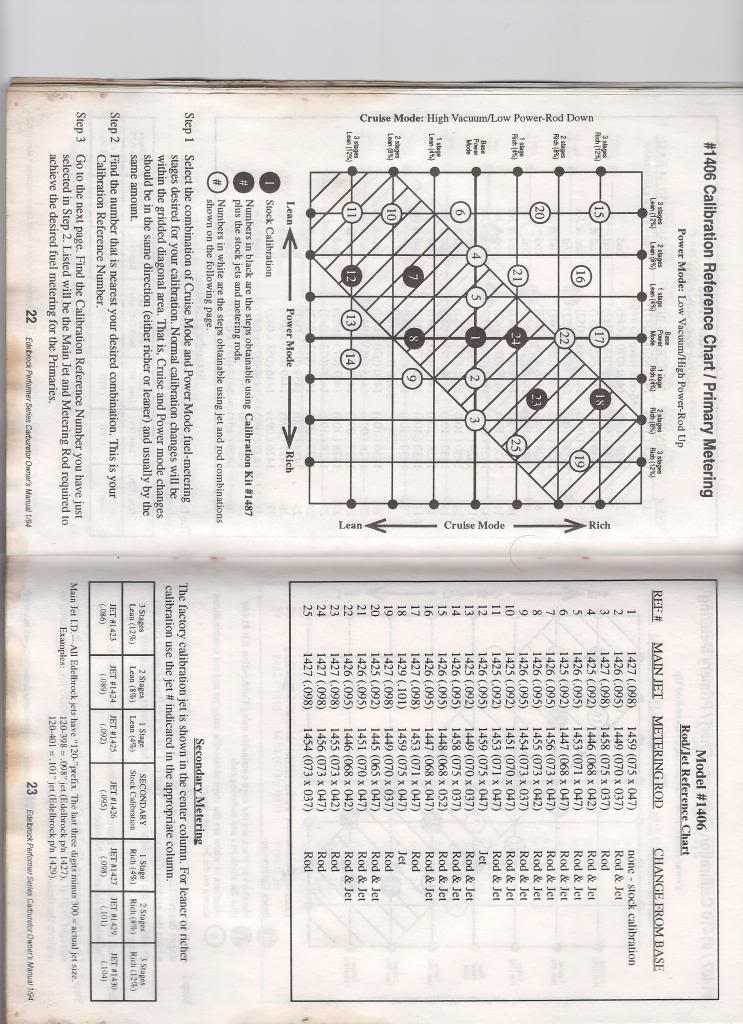

Alright, i printed off a book thats got all that info, but i dont really know a lot about carbs so im not sure what it means when it says. Air screw and when it says reset speed?

Re: Engine acting up?
reseting the speed just refers to the idle speed
the Air screw if you look at your last pic is on the far right on the throttle linkage
side of the carb
side of the carb
