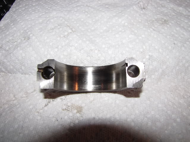

#8 rod bearing spun. Actually spun, not just wiped out. I've never spun a bearing before.
No rebuild for now. 454 shortblock is the best choice, I think. I have been offered (for a price) a 468 with ported 049's and TBD cam (idles rumipity, according to the current owner, who bought it to replace the ventilated 454 he was running in his 74 Corolla - but his engine turned out to be rebuildable, so he didn't use the 468).

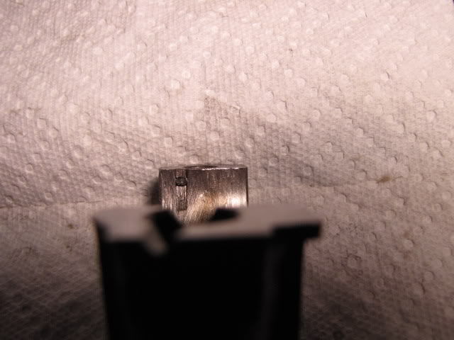

Cap & bearing halves
Cap surface
Back side of bearing halves
Sheared off notch
Cap surface
Sheared off notch
