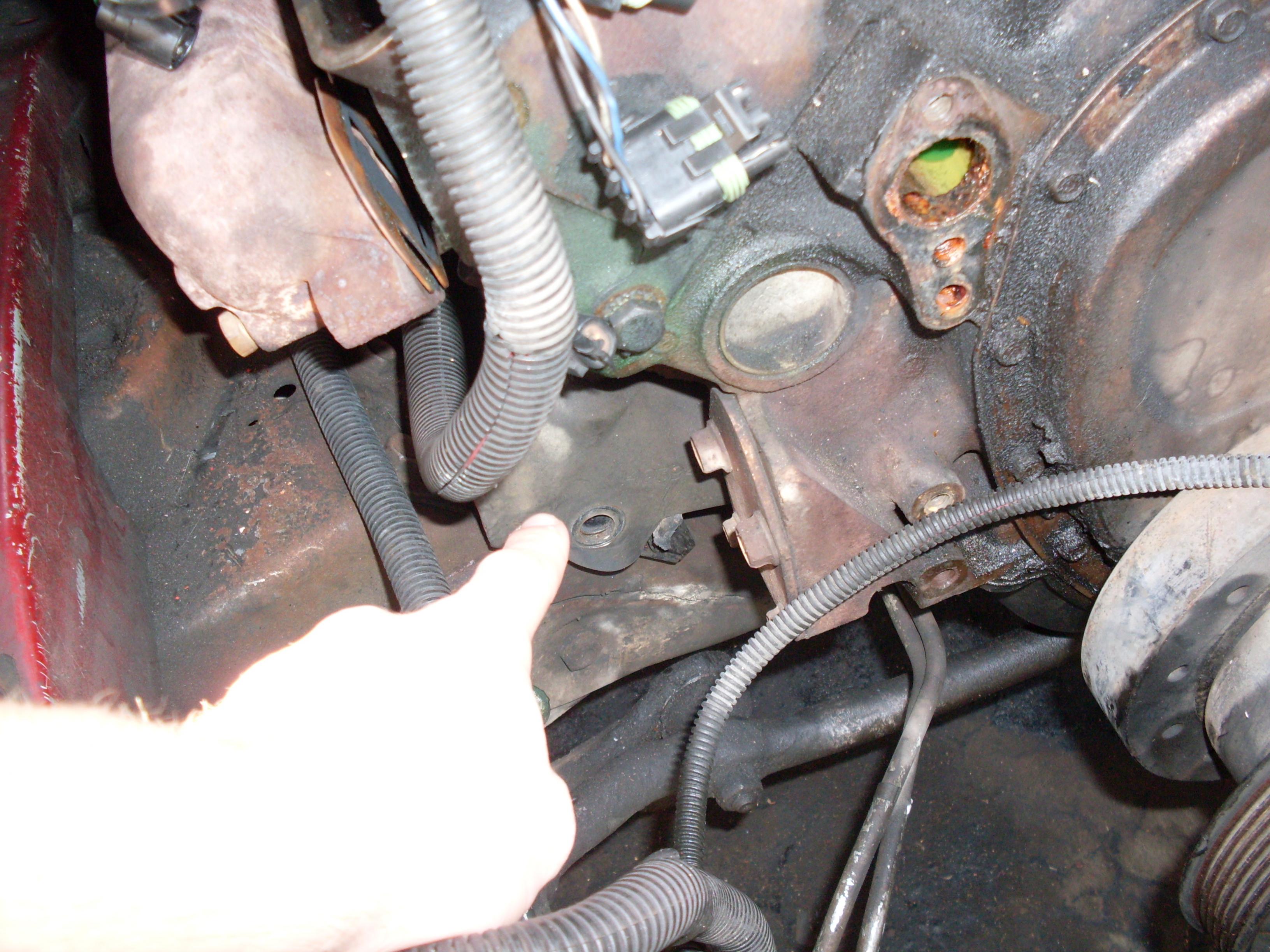

Sorry it took so long, no my motor is not 100% complete yet but the reason why i need the engine and tranny out is because im going to paint the the engine bay and also im sending the car to have the front end welded and fixed. Heres what i did so far: i have the front engine mounts out, all the accessories off the engine including the tuned port, and i have the radiator, fans, and all that out. All my hoses are disconnected and most of the wires are disconnected except for the starter which i will get to. What would be the next step from there? I got under the car but had no idea what to unbolt and look for, so if someone can assist me ill appreciate it. Heres some pics of what i have done so far

did you unbolt the fly wheel and trans/motor bolts? once those are unbolted start pulling. sounds like everything else is disconnected. you will have to shimmy the motor forward as you lift the engine unless you unbolt the drive shaft and cross member and back the trans off. hope your taking notes on paper, pictures, or have a photographic memory for putting it back together. i put everything in baggies and labeled it when i pulled mine so i didnt have to try and remember what bolt went where.

What i have been doing is once i take a part off i assemble it on my newer engine thats getting dropped it. So let me ask if im removing the transmission and engine together wont i need to unbolt the drive shaft?

Well im done for the day after cutting my hand. I could not find any tool that can fit to get that bolt out. I was looking around for alittle and saw 3 bolts forming in the shape of a triangle. 2 were on the bottom and one was on top, and then there was a bolt inside, im guessing its the "hidden one"? that was impossible to get out. I tried getting the bolt on top and just stripped it, that things on there pretty good. Just to make sure, by what im saying did i locate the right bolts to take out?

Sounds like you've got the right bolts there. That top one is a real PITA to get out. Putting it back in is even worse, at least for me.
I always pull the torque arm off the rear so I can get the driveshaft out without having to raise the rear wheels. It's only 2 extra bolts and when they are installed correctly, are very easy to remove. I only have 1 pair of jackstands as well. I only ever jack the front of my Camaro up when doing this kind of work because my garage is so small that once the front is up in the air, I can't get to the rear to raise it up. I have never had a problem with tension on the torque arm, but that may be because I unbolt it from the axle first, I dunno.
If you do leave the driveshaft in the rear of the trans as you pull it out, just make sure you don't nick up the end of it when it hits the ground. A nick there could damage the seal in the tailshaft when you go to reinstall everything and you'll end up dripping transmission fluid everywhere you go.
I only recommended removing the pulley based on my experience. I had to tilt my engine and trans at a pretty steep angle to get them in the car, and even the balancer got hung up on the radiator support. If the pulley was on there, I'm not sure I would have been able to get the engine and trans back in.
On the transmission, there will be 2 cooler lines. I believe they are on the passenger side. There is the dipstick/fill tube as well, I'm not sure which side that is on though. If you do leave the cooler lines attached to the transmission as 5-7 suggested, make sure you remove them from the radiator up front

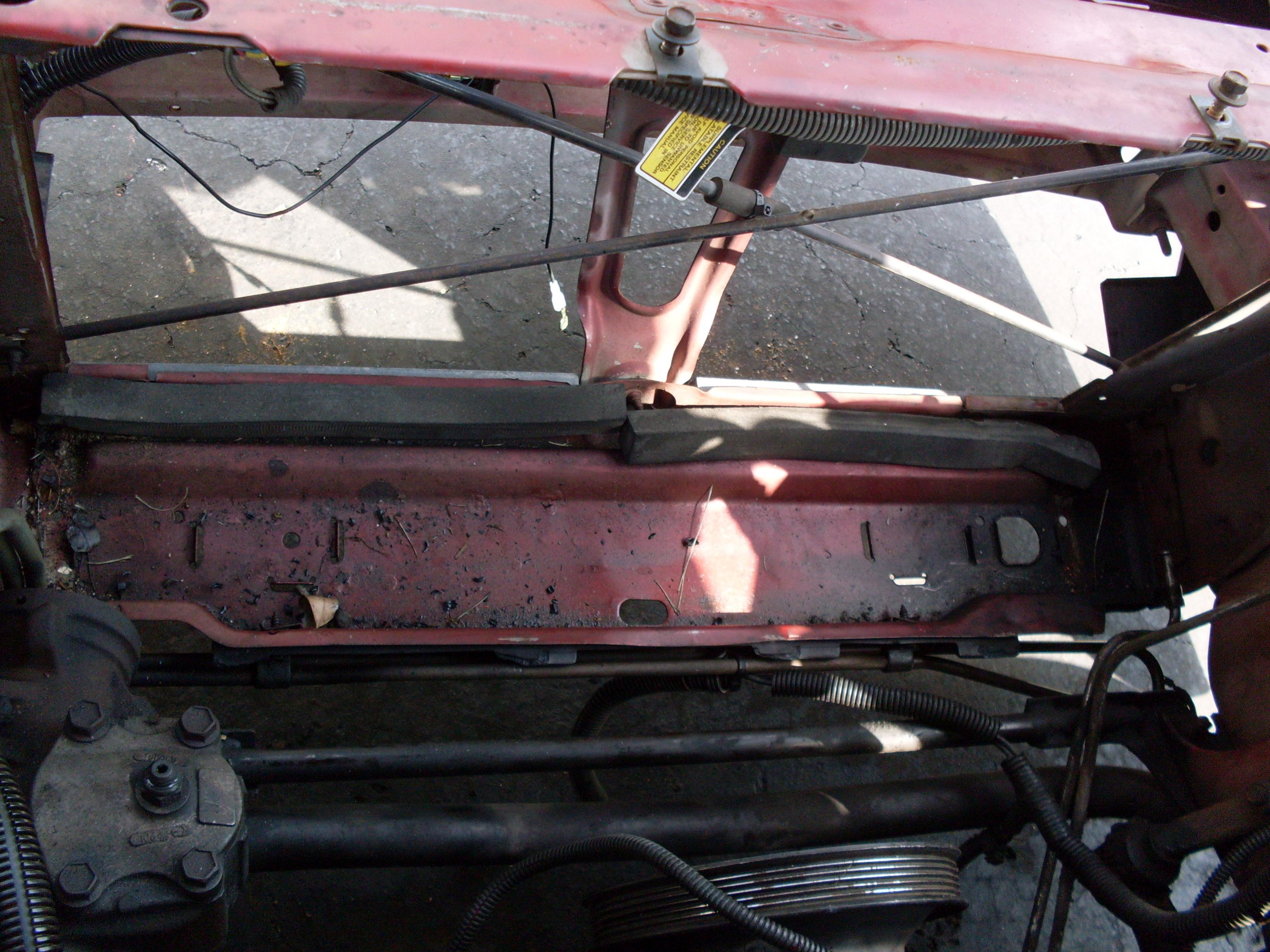

I have basically everything done. I have the whole radiator removed with fans, driveshafts out, tranny cable and speedo wire unconnected, front engine mounts bolts are out, all wires up top the engine are disconnected with all the accessories, y pipe disconnected, etc. What im waiting on now is the crossmember rubber mount, the tranny mount which those i think are very simple...i already have one of the bolts loose. My problems that torque arm, i have the back basically disconnected but the fronts giving me a problem. What im trying to determine is if im even at the right bolt that im "TRYING" to remove, i keep stripping the bolt because that things on there so tight. Front the passenger door to the drivers door going horizontal theres 3 large bolts, the one i was trying to remove is the top bolt. Does that sound like the right bolt? And the other one i was working at that i was completely destroying was the one kind of covered by the end of the transmission. There really wasnt any room for a socket to fit in there i had to use a adjustable crescent wrench which was stripping the bolt like crazy, but that was literally the only thing that would fit. No where in my haynes manual did i fit how to remove a torque arm. Ill re look again, do they actually show or tell you how to get the thing off?

Yes i now see the removal in the HAYNES book. It says remove the torque arm rear mounting bolts and nuts... Which im assuming i semi did since i couldnt get that other bolt out with it being the opposite way in as the other. Then it says remove the torque arm front outer bracket bracket bolts and remove the torque arm. So by what im understanding is those 3 bolts i saw i remove? 2 of the bolts were on the bottom side by side and the there was one bolt on top right above the 2 bolts side by side. Now is the way you all are telling me to do it just loosening the bolt that clamps the torque arm together and moving the torque arm out of the clampshell? If so is that the ONLY way it can be removed or can i do it the way i think by removeing those 3 bolts? I did loosen one of the 3 bolts, and tranny fluid started to drip, i didnt take it out because it was probably going to leak everywhere on my head but can i just remove those three bolts and that will take the entire bracket off? Or those bolts go need to stay in?
