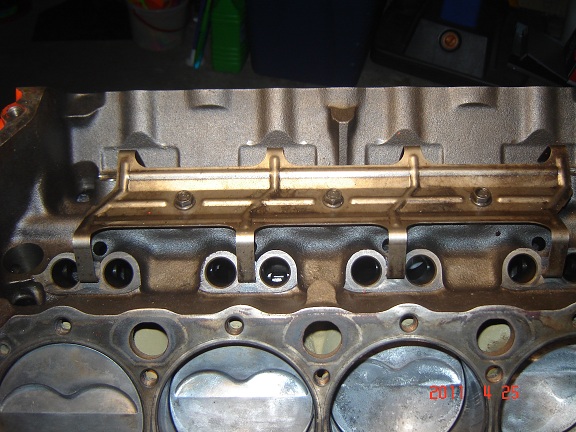

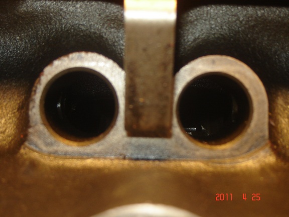

                          Ok guys, here are some pics I snapped of the motor. Not sure if you need others angles, just let me know what you think.
                          Attached Thumbnails Engine Swaping and Upgrade-dsc03708.jpg   Engine Swaping and Upgrade-dsc03710.jpg   Engine Swaping and Upgrade-dsc03709.jpg

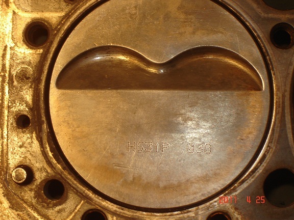

                          Here are a few more. The casting number was really hard to make out, but after process of elimination I got it figured out. Also the motor is stamped with the GM 5.7 logo on the right rear. Thanks again for all the advice.
                          Attached Thumbnails Engine Swaping and Upgrade-dsc03712.jpg   Engine Swaping and Upgrade-dsc03713.jpg

                          Here is some info I found on the pistons. Looks like they come from Flatlander Racing, and they are TRW pistons. Specs:
                          Part #H631P-30
                          CID 355
                          Comp Ratio
                          58cc-10.41
                          60.5cc-10.11
                          64cc-9.73
                          68cc-9.33
                          72cc-8.97
                          76cc-8.63
                          Comp. Dist-1.560
                          Piston Shape-F/T
                          Price/Each-$28.00

                          If you look at the sides of the block, you'll probably see "638" cast in large digits there.
                          That is certainly a roller-ready block. You even got the "spider" retainer.

                          58cc heads would probably give you higher compression than you want to live with on the street, unless they are aluminum. 64cc iron heads should be fine.
                          The "Comp. Dist" of 1.560 means the crown of the piston should be level with the block head sealing surface. Check to be sure. Most likely a .035"-.040" compressed thickness head gasket will be just right.
