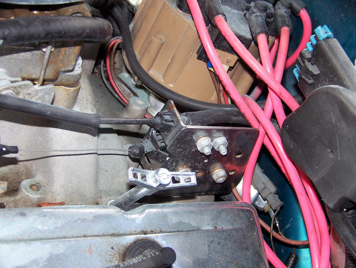

I use http://www.summitracing.com/parts/EDL-8030/ ... it's adjustable, but I had to modify it a bit by drilling a few holes to extend the bracket for the TV cable a bit closer to me Edelbrock carb. It also mounts to manifold - but summit does have some that mount to the carb. Edelbrock makes another one that is not chrome but same design, about $15 cheaper.

Do you have a pic of it installed. Also can you use cruise control with it

Don't remember on the cruise - don't see why not - I removed all my cruise control stuff. Here's pics:
Attached Thumbnails detent cable bracket-tvbracket1.jpg   detent cable bracket-tvbracket3.jpg
