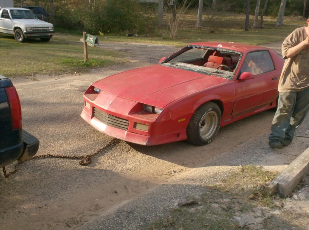

well i bought an old jet boat motor and got it tore down its a 60 over 396 i bought a set of 366 truck heads and ive got an old weiand intake for it im gonna run a comp ***** thumper cam and the hooker swap headers and i have a pretty good idea of how im gonna do the heater box and i will definetly be notching the cowl for distributer clearence since its not gonna be driven on a daily basis only just whenever i feel like it im not gonna run a/c so i'm thinking bout putting dual fans on the front side of the radiator and doing the 4the gen coolant tank/washer mod
heres how it started
and heres where it is now
