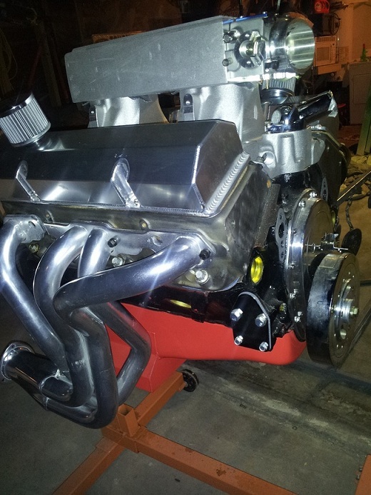

Lets just put it this way either I had bad eye sight that day or they just didnt match up. But all i know is that i am not getting scammed. My engine builder is a good friend and his saling the brackets for cheap to me and my mechanic my best friends dad and I tried fitting the brackets but no luck. So i am posting a picture of the build i have and idk if someone can see if this are the heads from where they switched or move the holes on the brackets.

Here is the photo.

Oh... The weird thing is by looking to that photo you have 2 holes on the right side on the right cylinder head as mine is 2 holes on the left side on the right cylinder. The thing is my builder said he will get them for me if they don't work I'll get my money back.

Your picture is very hard to see where the hole placements are.
