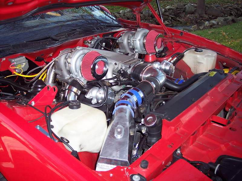

Joined: Apr 2008
Posts: 10,401
From: Utah
Re: Using a 350 block as a base for a 302
http://www.summitracing.com/parts/LU...s/?prefilter=1 http://www.ebay.com/itm/327-350-CHEV...item519e9b0427 http://www.ebay.com/itm/ws/eBayISAPI...m=350564404376 then I still have a couple grand to do cam, gaskets, bearing, oil pan and such.
that turbo kit is junk
the only thing out of it to use would be the turbos, the intercooler,the pipeing/couplers/,the wastegates gates the catchcan and the bovs, the headers will stick the turbos out of the hood of the thirdgen
everythign else u would throw away cause they are junk
the smart way to do it is to peice the stuff together seperatly
2 ebay 57mm turbos 118$ each
2 ebay 38mm wastegates 53$ each
1 rfl bov ebay 32$'s
1 ebay 32xx12x4 intercooler with piping and couplers 175$
misc oil lines and fittings 75$ ( and not cheap ebay stuff , get fragola pushloc fittings and parker pushloc hose)
misc flanges about 50 bucks
then build ur own log headers
thats what i did in my car , witht he aftermarket ecm, injectors and fuel pumps i spent ar und 1,900 bucks to put twin turbos on my iroc
Joined: Apr 2008
Posts: 10,401
From: Utah
the ebay turbo kits turbos seem to be crappy quality. ive seen ore bad reviews than good ones about them. the piping and all that would be good to use but i think as far as ive seen for the turbos to last at all they need to be rebuilt a way or something otherwise as far as bolting them on and going is concerned they tend to fail
the 57mm units are a much better fit and are only 118 bucks each

Joined: Apr 2008
Posts: 10,401
From: Utah
they wont fit under a normal cowl hood as the cowl isnt wide enough
there is that other nice cowl hood that is much wider but i dont belive its high enough
thats why i made my own turbo headers
fits with tons of room under a stock hood
