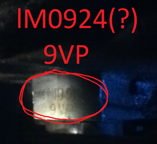

Engine ID Number: 1M09249VP(?) (I'll put a picture below, it's hard to see the whole number in the picture though).
Casting Number: 10066036
The Engine ID number is strange and I can't seem to find much info on it, maybe you guys can help? "9VP" is not used by Chevy in any of their Engine ID codes, so it's definitely a crate motor. The Casting Number however is much more specific, and most likely indicates a "Hecho en Mexico" crate engine. I've done some Google searches and found conflicting data on this engine. It appears to be at least 200 HP, but most sources say it's 250HP. Does anyone else have some more specific data on this 10066036 engine? It appears to have a stock intake and carb, or at least nothing special/aftermarket.

Here's a picture of the engine ID numbers on the crate motor:
