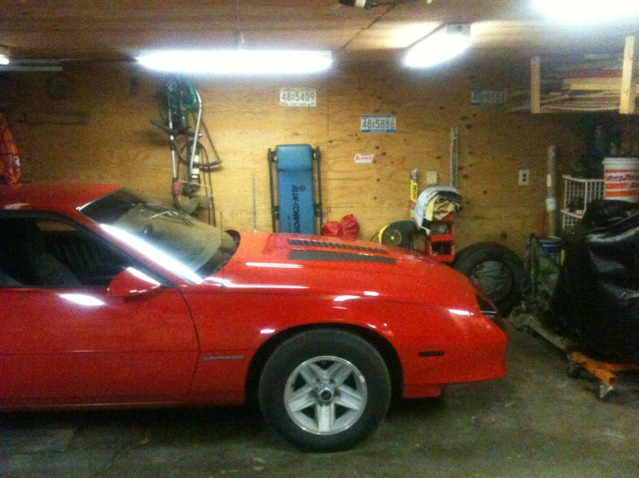

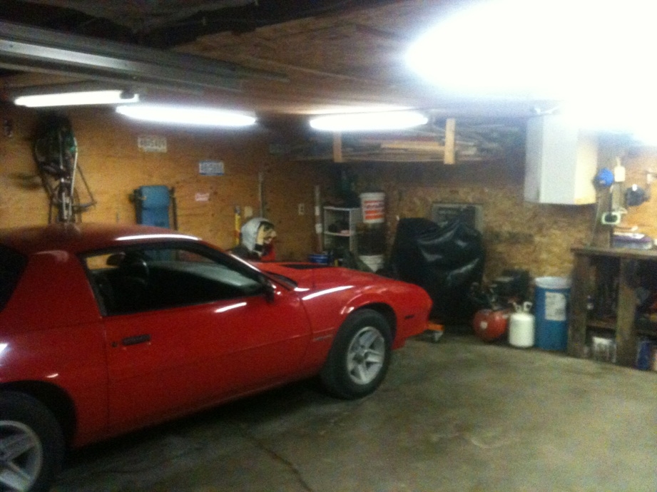

Re: using winch to pull motor?
I took some pictures of my garage to show how low the ceiling is and what everyone says.
well here are the pictures of the garage, i think i can do it up near the front of the garage as i have more room but will have to go from the side and keep it on the ground.

Looks like room to me. You could always pull the fromt clip.

you have plenty of room for a cherry picker, and i'd rather use that than rely on the rafters or trusses to hold a 550 pound engine... move all the stuff in front of the car out of the way to make more room.. get everything unhooked and unbolted so that the engine is just sitting in the car.. open the door and push the car so that the back bumper is outside... hook up cherry picker, jack it up, roll the picker straight back to get the engine over the front of the car, lower the motor almost to the ground, move the picker and engine off to the side, push car forward, shut door..
this whole operation will only take about 5 minutes and i've done it in smaller areas than you've got there.. one thing to watch out for is that you get a cherry picker with a long enough reach to get past the nose of the car. they really put a long nose on these cars.

Plenty of room. Much better conditions than I had. Just do pretty much what novaderrik said to do. You'll be fine.

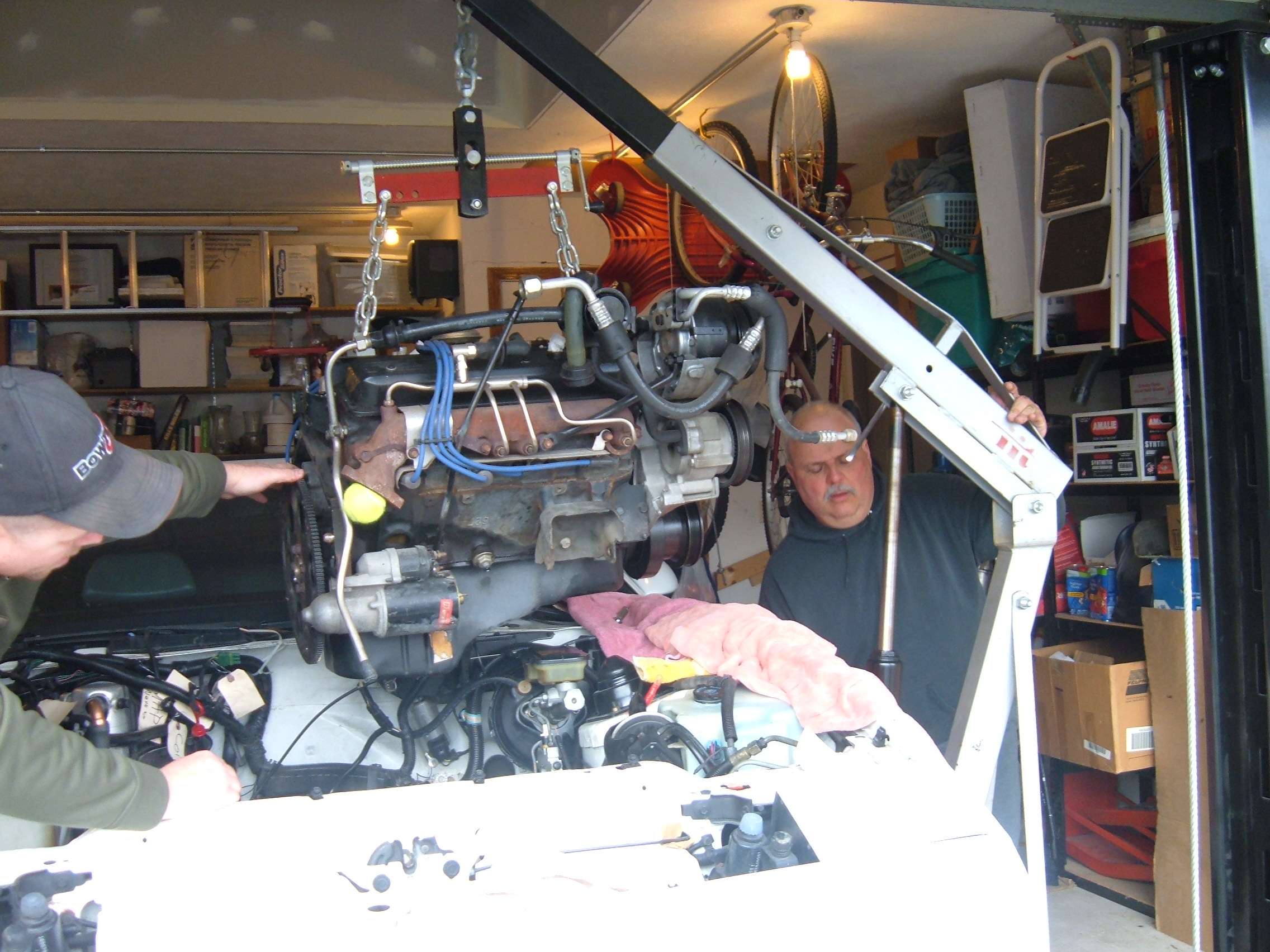

Dude, are you kidding? You've got more than enough room for a picker. I have a 7' garage door in my garage, and I just pulled the motor & trans (connected) out of my GTA with the garage door open, i.e. with less than 7' total height.
Here's a pic during removal that shows the motor partway out. The take-away here is that you can see that we made sure the hoist was as close to the motor as possible. You can see the garage door here too. See how close the top of the picker is to the door? It turns out the car was too high, so we had to lower the car to have room.

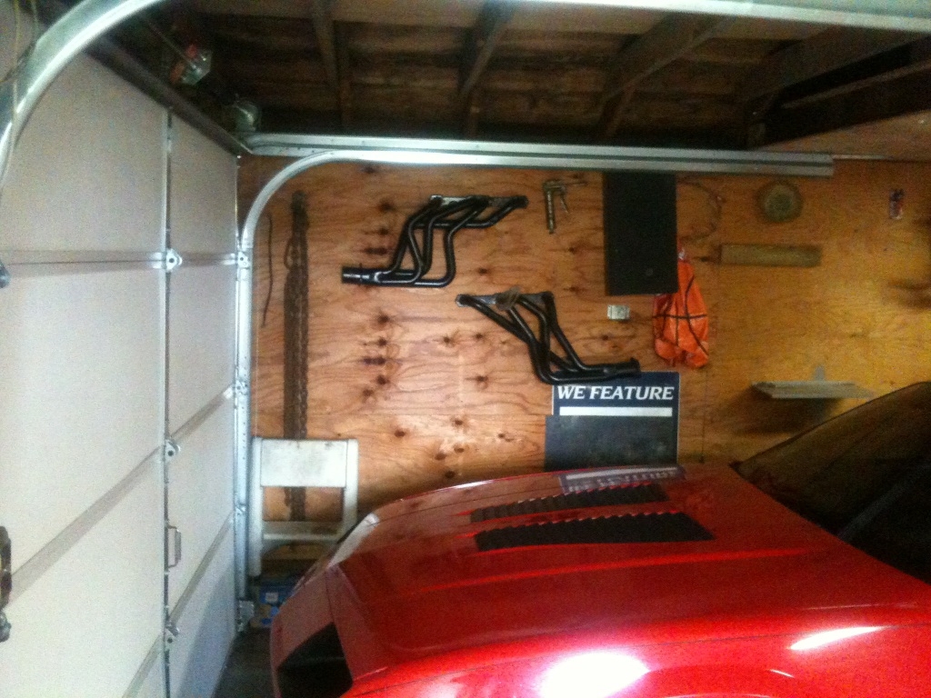

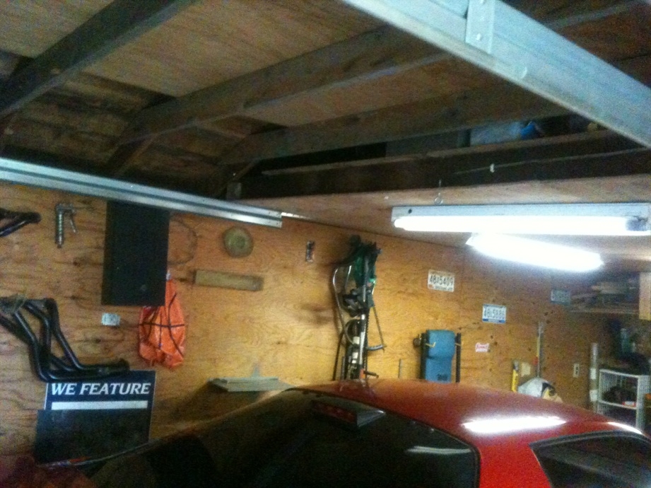

took 2 more pictures of the area i plan on doing the swap, plan on going in from the side to be able to have more room and leave the door shut.
pull off the nose of the car, your going to have to anyways if you go with the HF cherry picker, theres just no other way to get the boom to reach. (used the same one you mentioned to pull my engine).
as for the electric winch, IF you decide to go that route, get and use a ****** block with it, cuts the cables working load by 1/2. also, something to remember, those winches usually are built to run on 12v DC current. cant exactly just plug em into a wall outlet

Old Sep 18, 2012 | 10:06 PM
watajob's Avatar
iTrader: (29)
Posts: 1,410
From: Location, Location!
Car: 92 T/A 'vert
Engine: Mild .040 over L98 4 bolt mains
Transmission: Mostly stock 700R4, 2600 Vigilante
Axle/Gears: LS1 3.42
The side works just fine, even with an engine leveler and the chains not snatched all the way up.
Attached Thumbnails using winch to pull motor?-dscf1756.jpg   using winch to pull motor?-dscf1757.jpg   using winch to pull motor?-dscf1762.jpg
