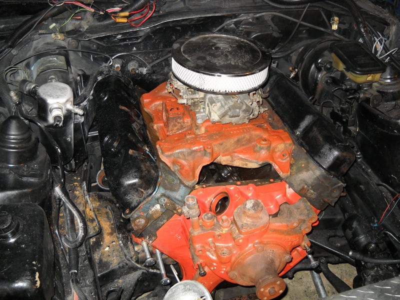

Its not pretty yet just a quick mock up to do mounts and check fit steering and brakes worked easy had to shave some off the ac air box and flip sump on pan for crossmember with a fabed pickup tube. Probly going with 1 3/4 primary tube shorty headers have to fab next to meet up with the sidepipes. Have a 13 point roll cage in with .250 wall 1 1/2 tube and plan on puttin in major sub frame connectors also reinforcing the sub frames

Thank you sir I have figured out how to put pics up hope everyone enjoys the process as much as I Next week will be hedders should be fun

Originally Posted by 88 Rs Camaro
im surprised it fits that well, the savoy's engine bay was wider then the 3rdgen and headers were a total pain in the ****, we also did steped headers 2 inch to 2 1/8th long tubes
if u plan on any kind of hot engine setup i strongly advise u to use atleast 1 7/8's primarys
what do u plan on using for heads/intake ?
i look foward to watching ur progress as i know very well what the 440 is capable of

btw i wouldnt try to adapt the engine mounts, i would use a front engine plate to make room for the headers
Tks already adapted the front mounts just need a bit more to hold it in
i would ditch them all together and go with a front plate it makes a ton more room for headers

Originally Posted by UnstableAviator
Looking good man, at first I doubted the project.
Tks it is all fitting well Looks like the tough part will be the ac at this point.
I may but so far i have some hooker comp headers that may work with some tweaking wont be the full 2 inch primarys but they are very close and shortys that will dump right in the collector
