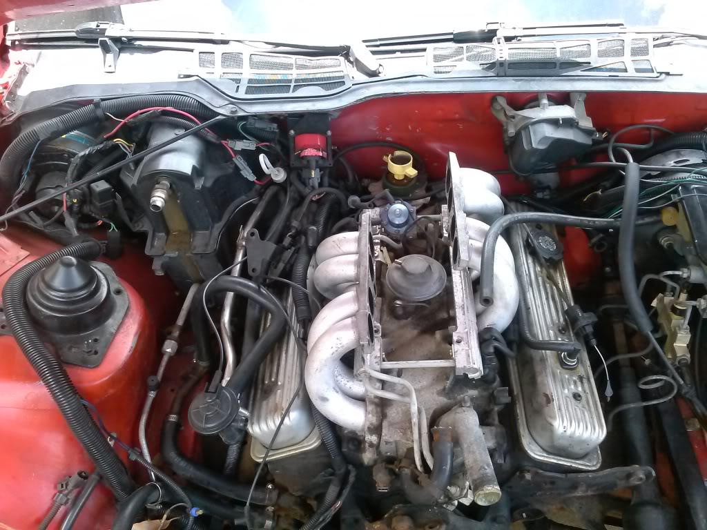

Already got over 30 pictures of under the hood so far, and plan on having my wife take more as I go so that if i do forget something I will have something to fall back on. I hope that I am not back here in a few weeks asking "does anyone know where this goes" LOL. Thanks for the tips

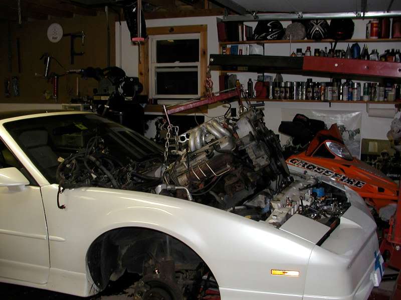

One suggestion I have is to make sure you get the big cherry picker, not the 1 ton toy that some places sell. While the 1 ton is strong enough to do the job, it doesn't have enough reach to get directly over the motor from the front unless you pull the front bumper cover off the car, which is a lot of work. You can go in from the side, but in my experience, that's a pain too, because as the motor comes up, you want to be able to easily move it forward.
As you can see from this pic, even with the big one there's barely enough room. I wound up needing to stand on the back of my cherry picker to keep it off my bumper. In this pic you can see how far forward the engine already is, and how close the cherry picker is to my bumper. I had to tape that foam to the front of my bumper, and the cherry picker was up against it for a while.
here is the pic I took last week when working on it

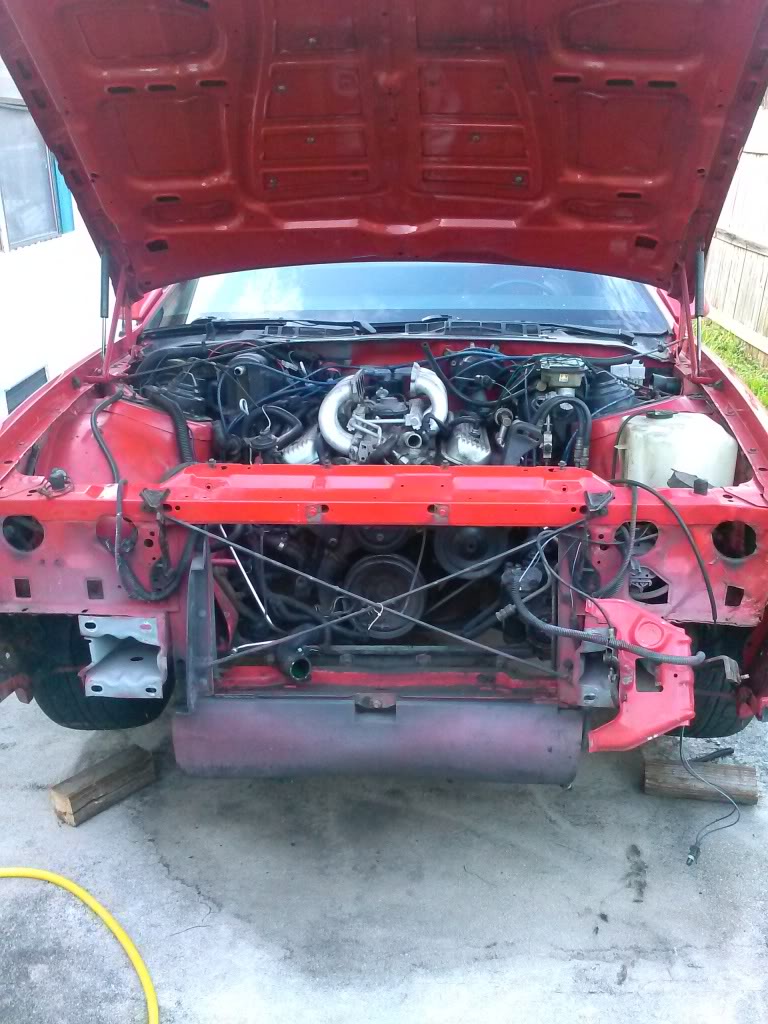

So that is where I am at right now. Almost everything taken off and disconnected but a few things here and there. Mainly the Motor Mounts... HINT HINT (need help trying to figure out a way to get to them)
