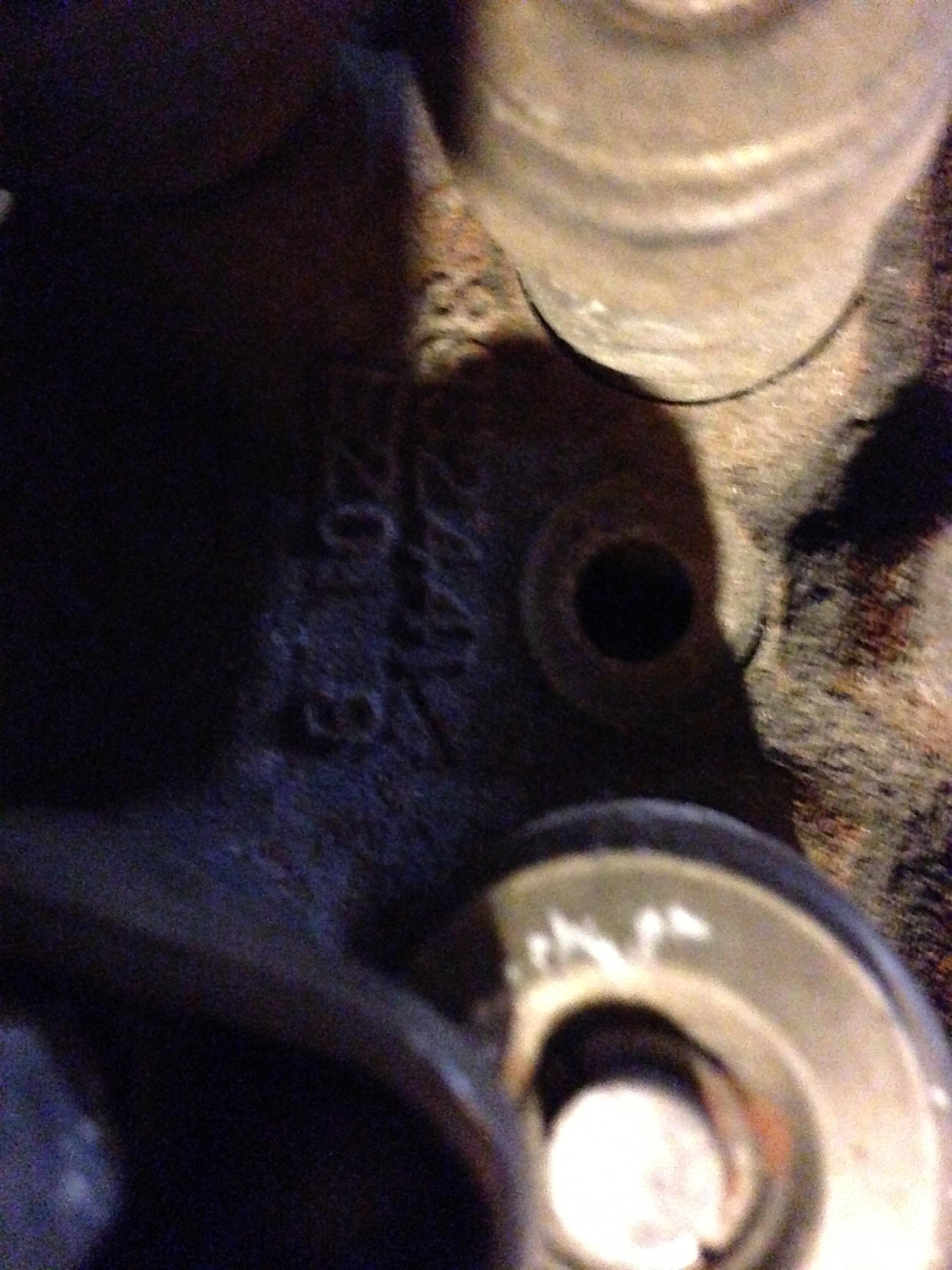

Here are some pictures of the motor, more pictures coming soon! cant wait to get this project rolling! I would really appreciate input in this project due to I have never tackled a build! I have wrench time, doing normal maintenance like struts shocks ball joints things of that sort. Im on a due to being in college full time but Its okay if the project takes awhile to do, I will not slack on what I need. Thank you for taking your time and reading!

Now, if you got the stamped number from the pad in front of the right cylinder bank, it may tell you more. But, all that is really important is whether it was a 327 or 350.
Get the casting number off of the heads and post that here. The casting number is located under the valve cover between a couple of valves. It will likely be 3927185 or 3927188. Look at both heads, and look carefully - a 5 can look like a 6 can look like an 8. If they are 1969 heads, then it is fairly easy to say two things about them: 1) They don't have hardened exhaust valves or seats (unless that was done to them sometime in the past); and 2) they aren't very good heads. Find out what you have, and we'll go from there.

although its difficult to read the number off the heads from the picture, I presume the numbers are 3983241 , these numbers were also on the head I don't know if they would be helpful. E20 9 and Gm7.

The casting # is probably 3932441. The "2441" at the end is clear enough, which is good enough to identify them. 69-70 350 heads, 76cc chambers. The large chambers will make compression low, but at least you have flat top pistons.
