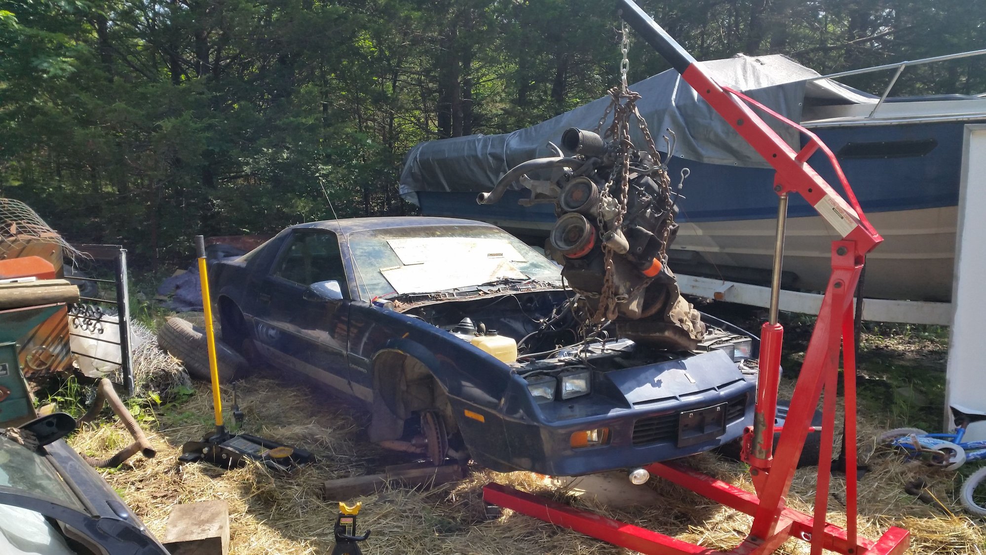

I've had a 1985 Berlinetta 2.8 since I was 16 years old. I kept it around to eventually bring it back to life when I had a real job. I found a GM Gen V BB 427 Tall deck with all the gear and mounts. It has 15,000 miles on it. Came out of a 1991 Kodiak truck. I know there are fitment issues with this engine, but Ive heard good things as well.
This will be my first build, so Im a newbie.
I know it has forged pistons and a steel crank. With my current budget, I want to try and keep those for now. I know they are heavier and low rpm, but I'm guessing they are strong and reliable. The tall deck has an extra oil ring on the pistons. I have about a $2500 budget and I'm thinking heads and a cam would open that engine up quite a bit until I can afford more. Anybody have personal experience with this engine? I wouldnt know what valve sizes or brand for the heads or what cam to get. Any intake recommendations?
