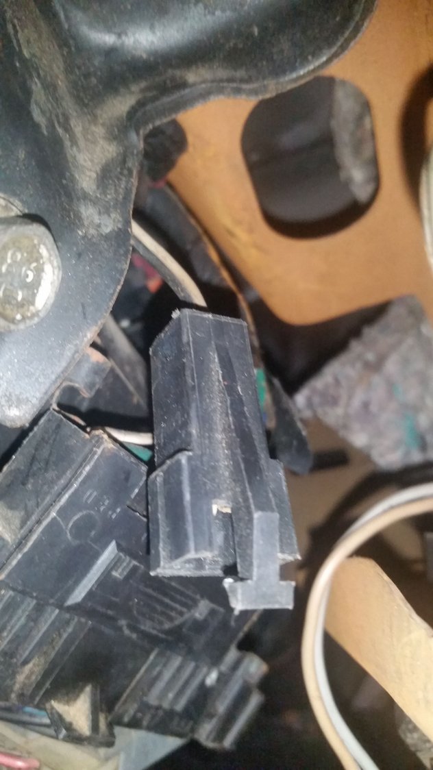

This plug goes to the top of my headlight switch.
Does anyone know what plug this is?

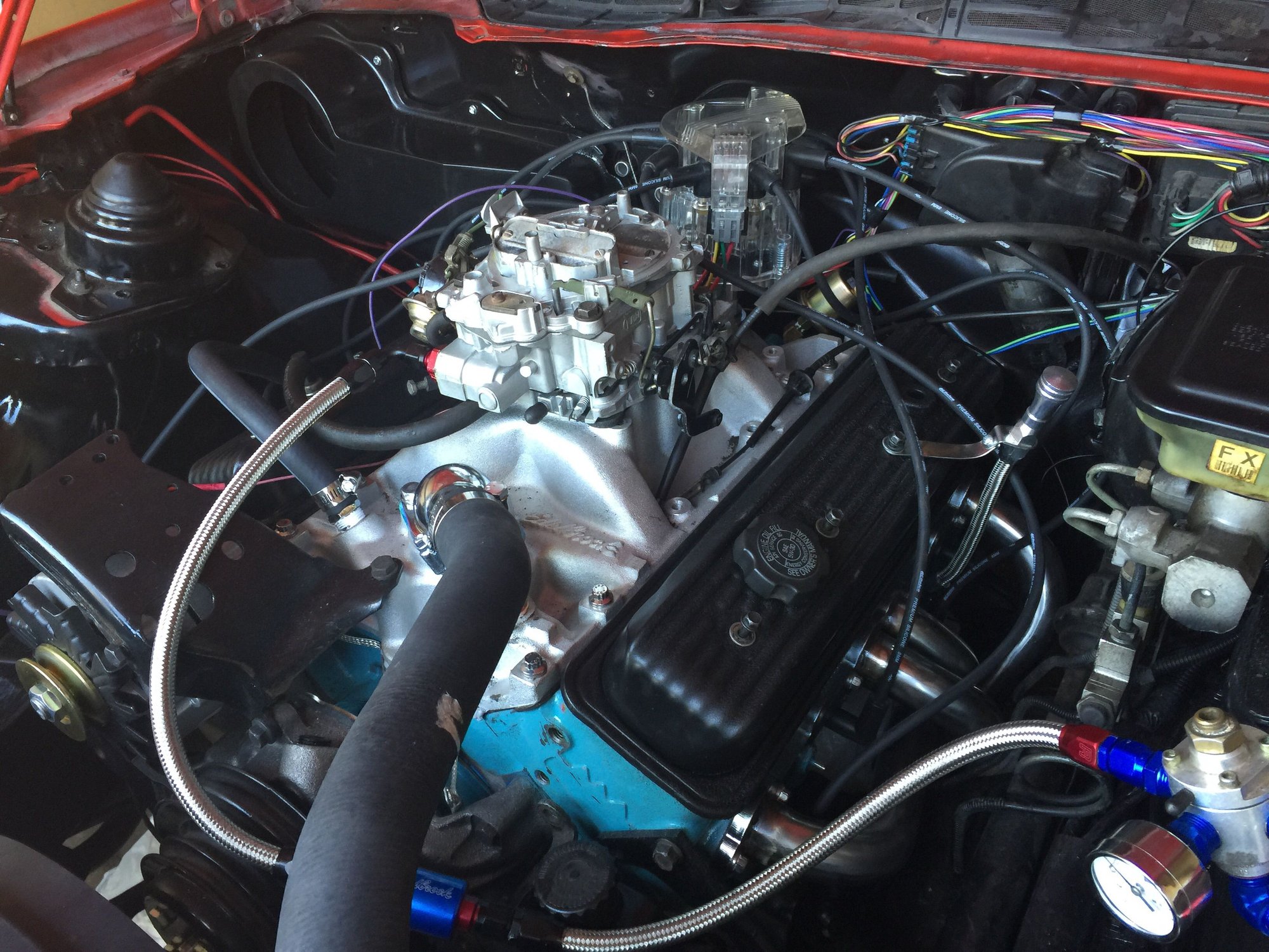

Pretty paranoid about breaking my engine in so I used the lunati additive as well as brad penn break in oil.
Temporary mount for the taurus fan. I do plan on making a nicer shroud when I get a chance.

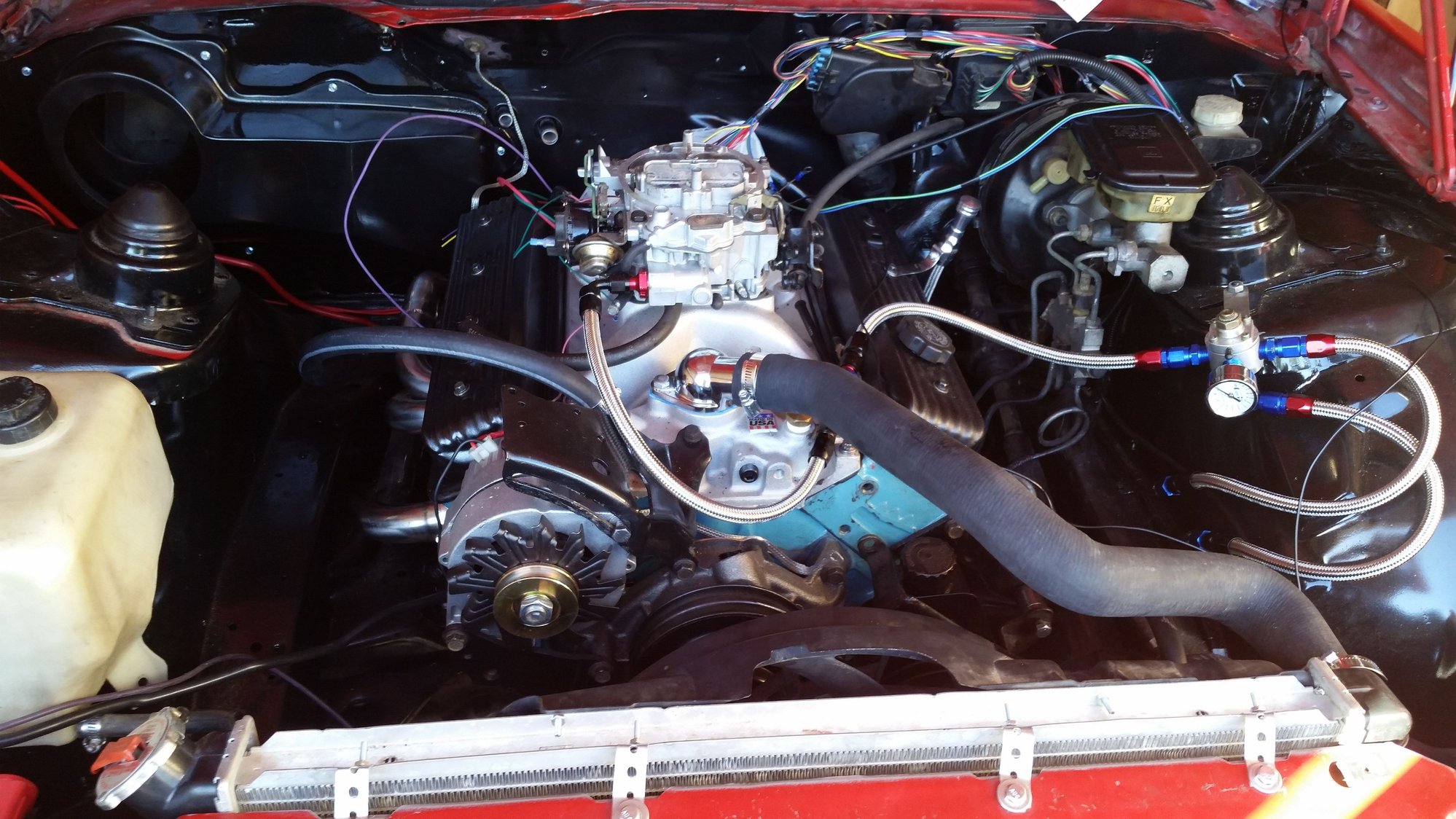

distributor is in
Original tbi car but it looks like the cable will be too long though I still need to find. Throttle bracket that works with my intake and carb

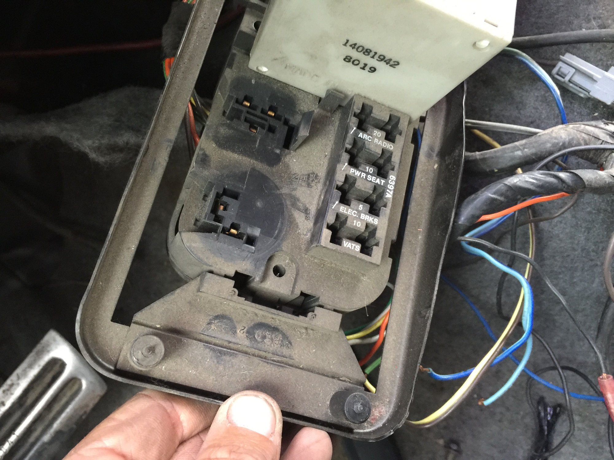

i just noticed the pass key box and the other black box that has a fuse labeled vats. Do I need to remove these or do anything with them for this carb swap? I've already done the bypass for the start enable relay.
While I was messin with the steering column I ended up removing the weird metal piece that you have to press to remove the key. Will it be ok removed?
