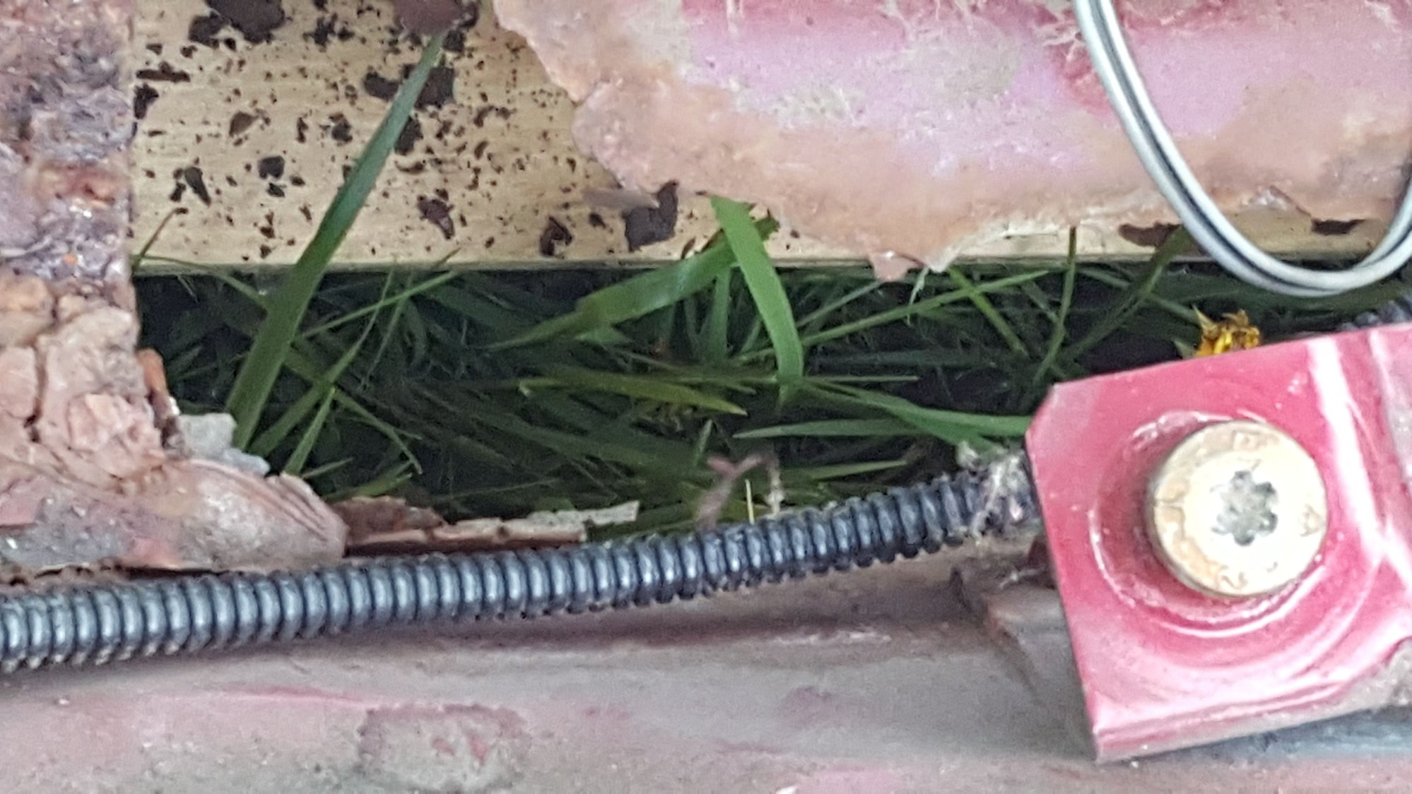

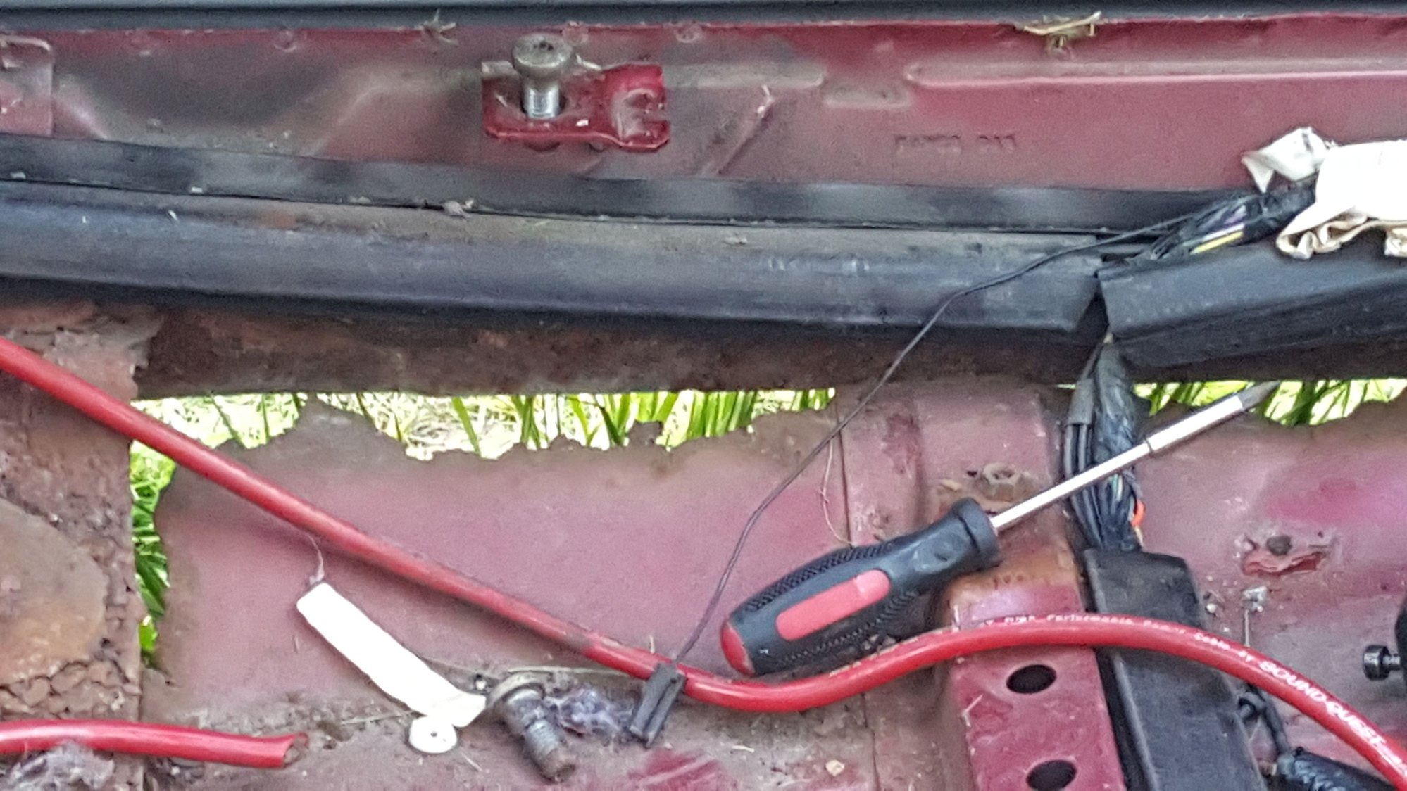

Here is where we stand now. The gas tank and lines are out. Not sure how the lines were not leaking, they broke as soon as I touched them they were so rusted. Included are a couple pics of the floor in need of repair. After talking with a transmission builder I'm gonna go with locked 411s in the rear.
