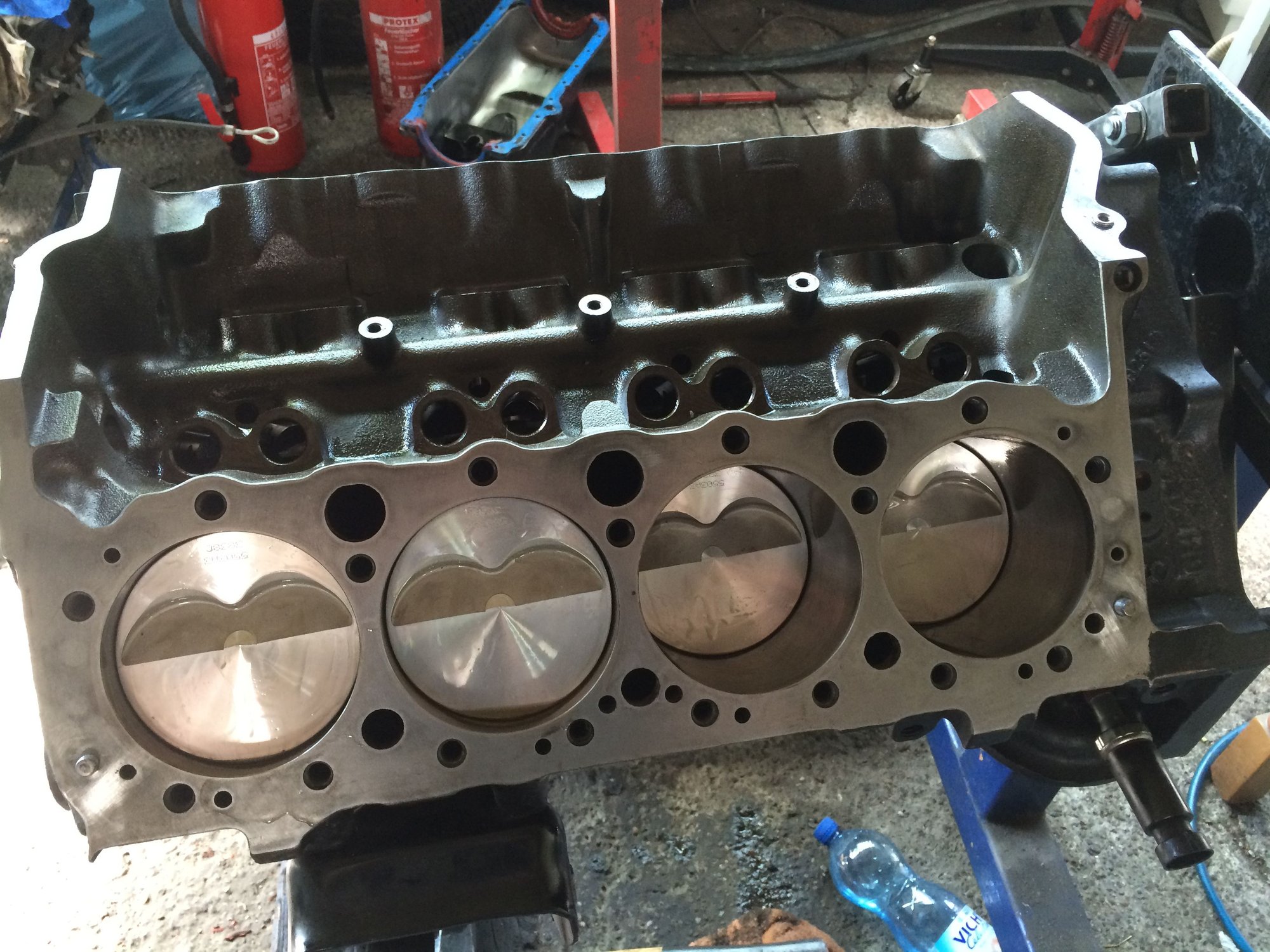

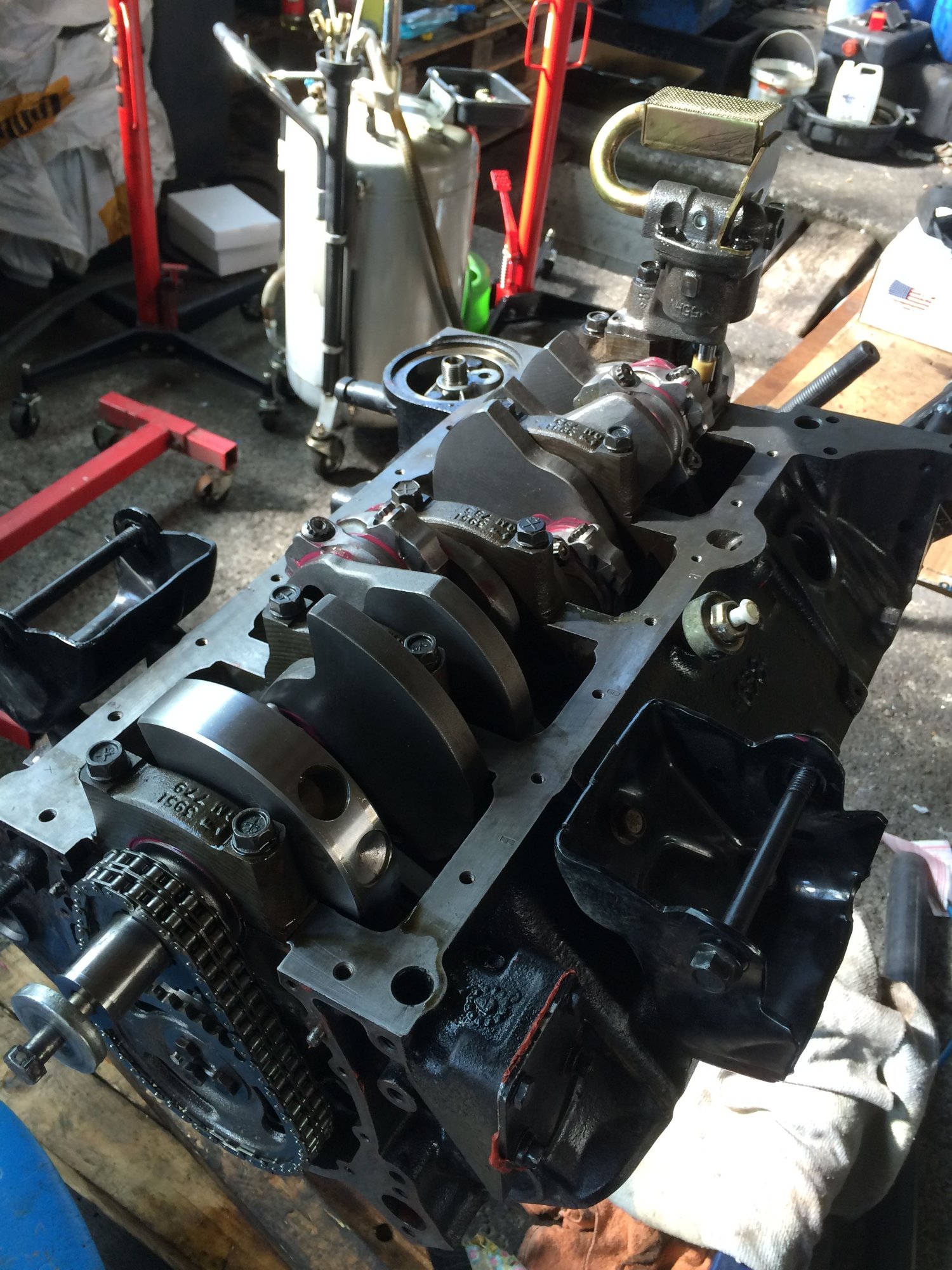

Today, i removed and disassembled the engine completely.
There is a Scat stroker camshaft with 3.750 stroke. Connecting rods are 5.7". Pistons are Probe P3831F-030.
stroke/2 = 1.875"
+ rod = 5.700"
+ compression height = 1.425"
9.000"
deck height 9.025" - 9.000" = 0.025" deck clearence.
So, i have to go with pistons with compression height 1.560" to get the same deck clearence.
How do you think about these pistons ?
http://www.summitracing.com/int/part...4030/overview/
Piston ring thickness is the same. Can i use the piston rings from my old pistons ? Then, i don´t have to file new rings to the gap.
With these pistons, Felpro 7733PT2 (compressed 0.039") and 355 cui, i will get a compression ratio 9.71:1.
With my old stroker setup, i had a compression ratio 10.52:1.
I think, 9.71:1 should be ok. How do you think about these pistons from summit ?
stroke/2 = 1.875"
+ rod = 5.700"
9.000"

With 0.025 deck clearance, you'll want a thin head gasket to obtain appropriate quench/squish. Or you "zero-deck" the block, and use a typical .0.039--0.040 head gasket.

Don't forget to have the new assembly balanced.

I´ll go with 1.560" compression height. I think, it is safe with the same clearance than before.
Balancing. I am using a brandnew scat crankshaft with harmonic balancer from 350 cui engine. Is that ok ?

EDIT 2: Or, perhaps, it is the easiest way for me to buy a balanced rotating assembly. I was looking for assemblies in Summit and Jegg´s but i can never find the compression height from the pistons. Can you recommend a good 355 cui rotating assembly for me ?

Were you using a neutral-balanced flexplate? SBC tend to use one of three balancing styles on the flexplates: Neutral, offset weight for one-piece seal cranks, and offset weight for 400-stroke cranks. The one-piece seal flexplate won't bolt to a two-piece seal crankshaft.
Why don't you contact Mike at http://www.lewisracingengines.com/

I would go with hypereutetic pistons on a fuel injected engine, they are dimensionally more stable with the usual temperature variations. Forged only if using forced induction, Nitrous or a carb.
Floating pins with spiral lock rings would also be a smart choice.
I have KB series hypereueutetic pistons, ring gap is very important, file to fit is probably best. https://www.uempistons.com/catalogs/...ve_catalog.pdf
Check out the head gasket choice for your heads and pick a good one widely used. Compressed thickness mesure is important in order to achieve an optimal 0.040-0.045 piston to head distance (quench), for effective squish effect and optimal combustion. Like Shurkey already pointed out.
If you'r not able to achieve proper quench, with your selected parts, you will need to mill the deck of the block.
The goal is to get the quench distance as close as possible to 0.040-0.045 and this is supposing the deck is nice and straight, otherwise you also need to take into account the amont that will get removed when milling the deck.
Balancing, any rotating assembly will need to be balanced, new parts or not.

If you can order your rotating assembly inspected and balanced by a good shop and serious people, then that's the way to go!

Ok, i think, it's the easiest and best way. You are right. I wrote to Mike.
I was looking to rotating assemblies from knowed manufactures. Scat and Eagle. I was never finding a kit with a good compression ratio, piston compression height.

Hi. I am Jan1980... i found my old account again.. :-)
Just want to give feedback. Engine runs fine. It is running with 65pph police car injectors @454 bbc throttlebody with mike jones cam and afr 195 heads. I have to make small changes in ecu maps, but i cannot drive at the moment, licence plate is expired till may.
@owner: I own 88´transam. In 2018 i can make german "historic license plate", it is much more cheaper then. And german "TUEV" inspectors check everything before exhibiting this plate, i think you know the procedure. BTW, owner, we wrote a lot on ICQ before years. You remember ? I bought your PMD seats. And you made your Fiero project.
