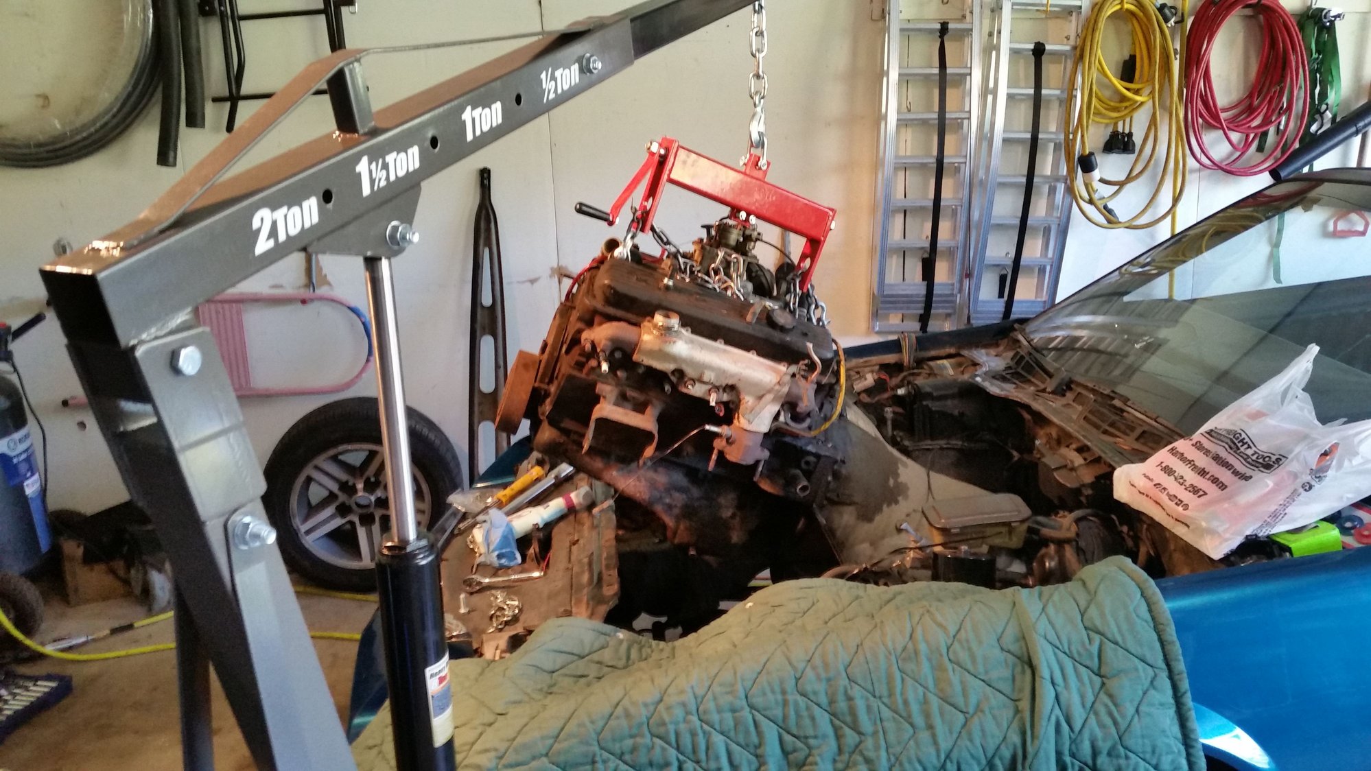

Next, unbolt the motor mounts that connect the engine to the K-member. Don't worry it shouldn't drop especially if you have a jack holding the trans up. Connect your chains from the leveler to the engine. There should be two brackets on the top of the motor, one on the front of the motor on the passenger side and the other on the rear corner of the drivers side. Depending on how long the boom on your engine lift is, you may have to lift the engine from the side of the car. I had to on mine and it worked just fine. Just make sure you cover your fenders with a thick blanket or something similar to prevent them from getting scratched.

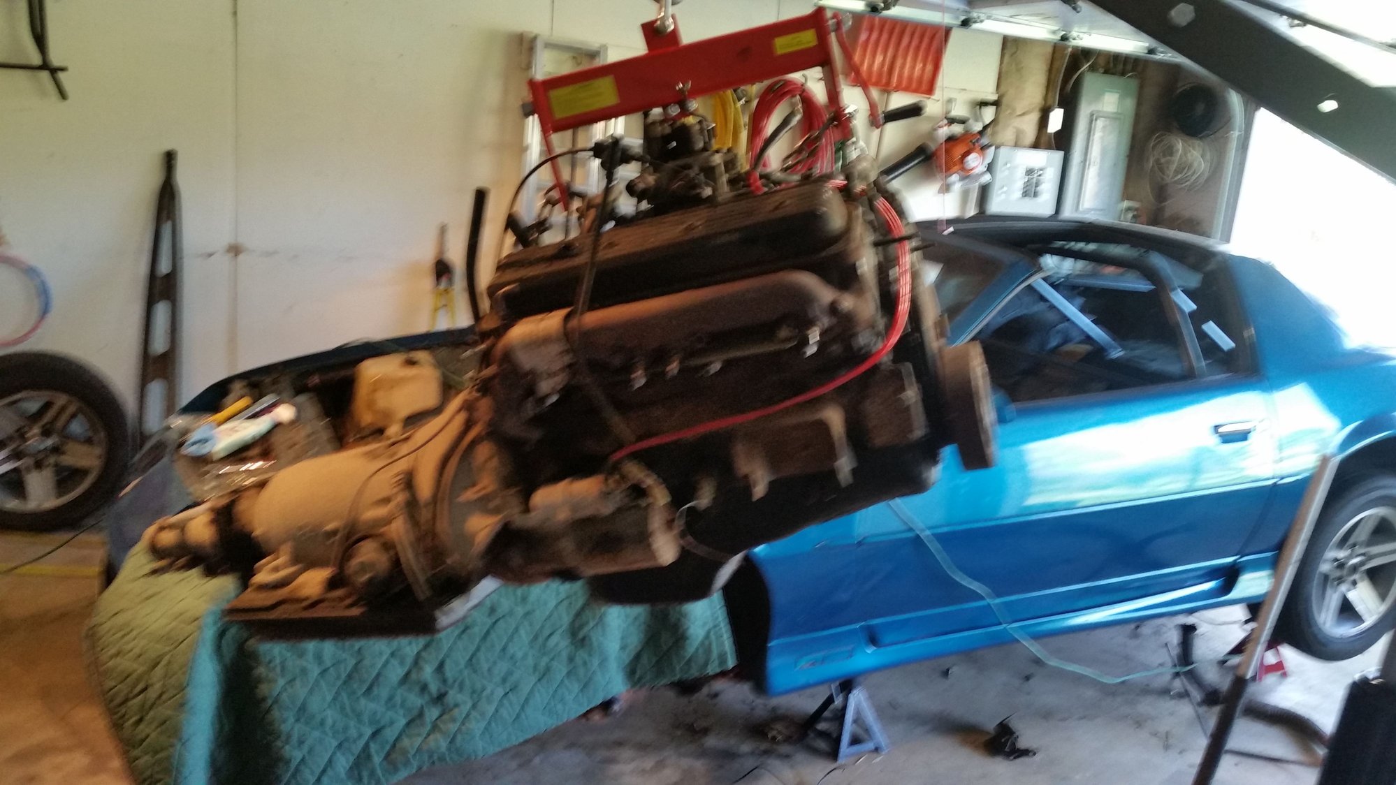

Lift the engine lift just a few inches. After you do that, remove the jack from the bottom of the trans. The crane should be supporting the weight of the engine now so its ok to remove the trans jack. Lift the engine out slowly and adjust your leveler so that the trans is angled downward and as you are pulling the engine forward, keep lifting it at the same time. This will allow the motor and trans to come up at an angle so it won't hit the front. Make sure the motor does not hit the master cylinder or any brake/fuel lines. It will break them.
After the motor and trans clears the engine bay, set the motor down where you want to. I put mine on a dolly so I could move it around if need be. I will be taking it to the scrap yard though sometime this week. My 305 had oil in the coolant and the heads had been leaking for a while so mine was finished. Plus the only thing a 305 TBI is really good for is a boat anchor.
tomtom,
Which cherry picker and leveler did you have in the pictures?
Would you buy them again for a SBC/trans. swap?
