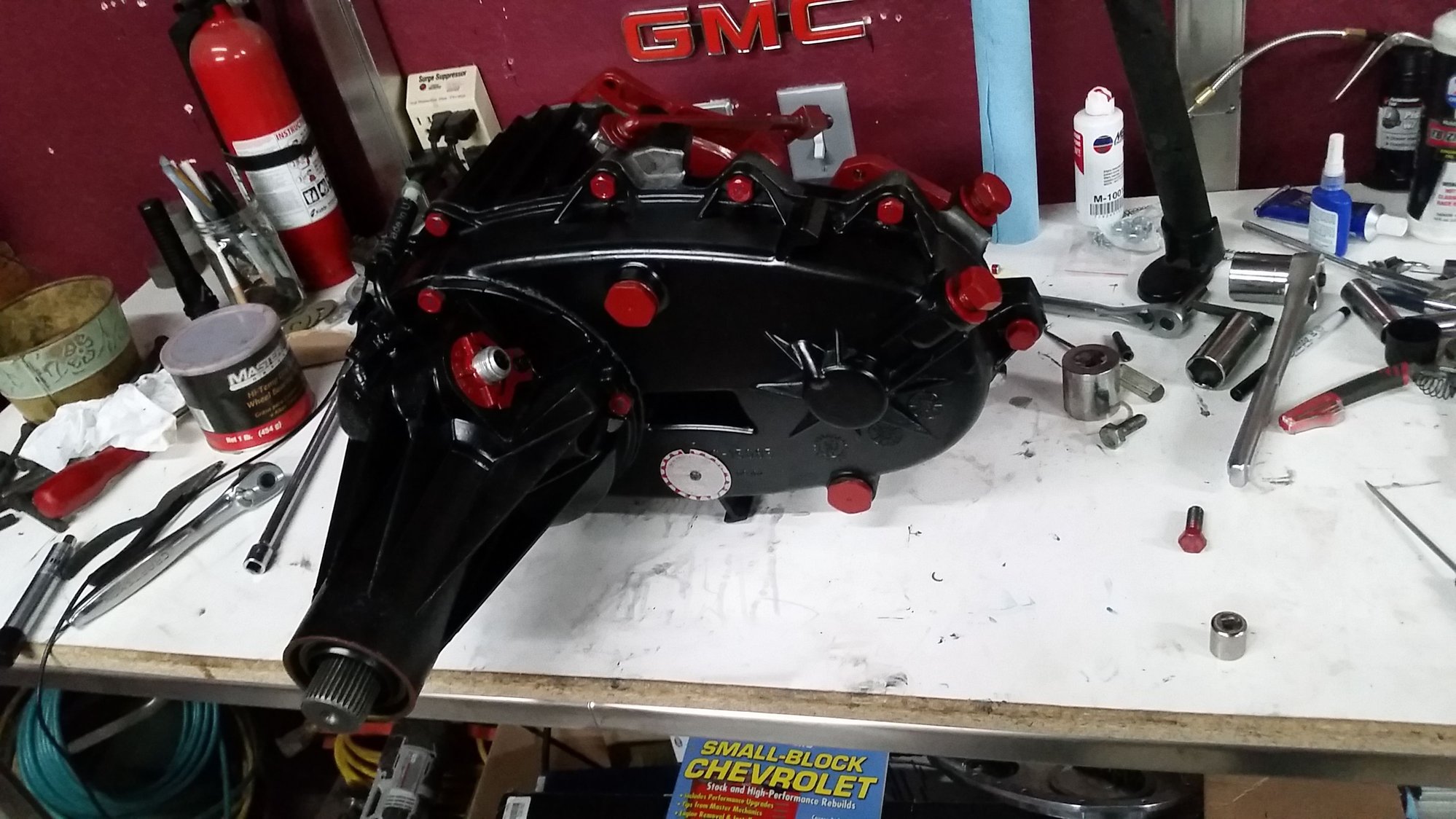

The red and black theme has been done throughout the trucks build. Here are a few examples. Hope I don't get in trouble for these
Tcase rebuild.
