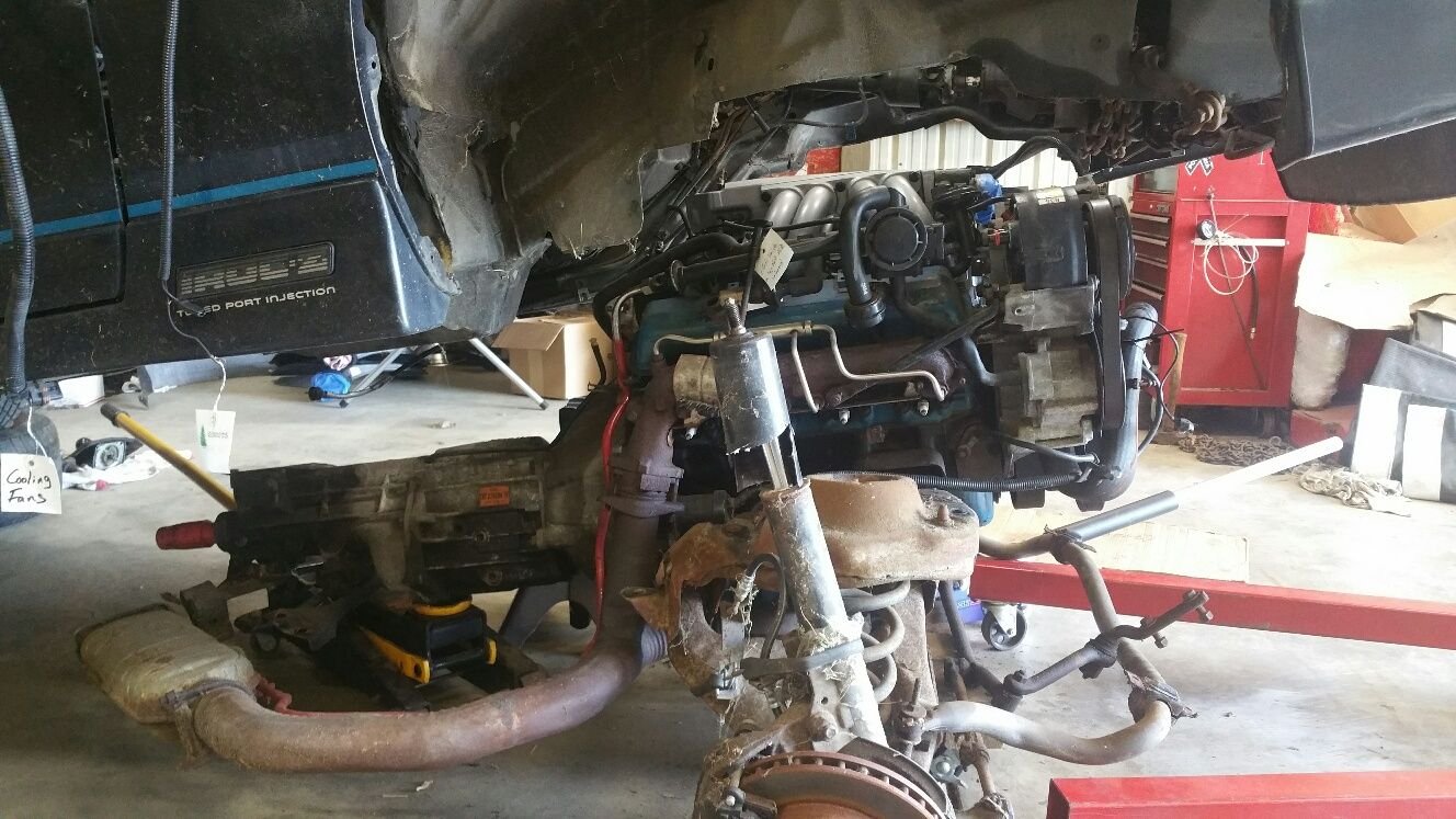

ok, well, I went against the grain and took it out the bottom.
Left all the front accessories, suspension, sway, steering, exhaust up to the cat attached. Removed the wheels and sat it on a dolly I had built before. Sat the trans on a jack and rolled it all out.
I thought the eng harness would unplug somewhere like on a 4th gen, but it doesn't. It continues on around to the front picking up everything under the hood.
