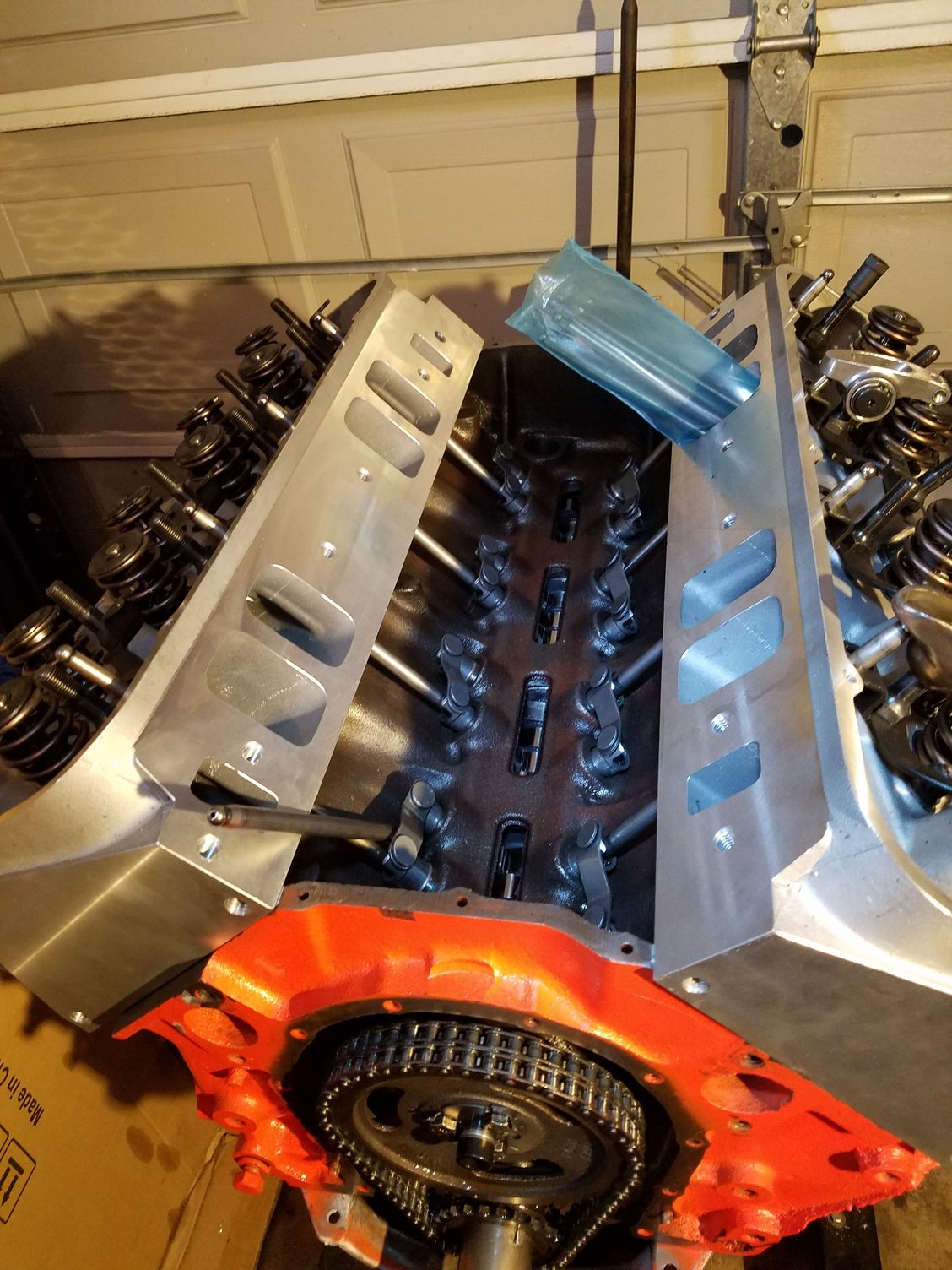

So after the cam fiasco comes the rocker studs and push rods fiasco, stock studs are 1/2" too short and stock length push rods are way too long for the roller rockers, they would work for the stock stamped steel ones though, i need 7.900 on intake and 8.650 on exhaust, Summit Racing said they can help with some Trick Flow stuff for $180

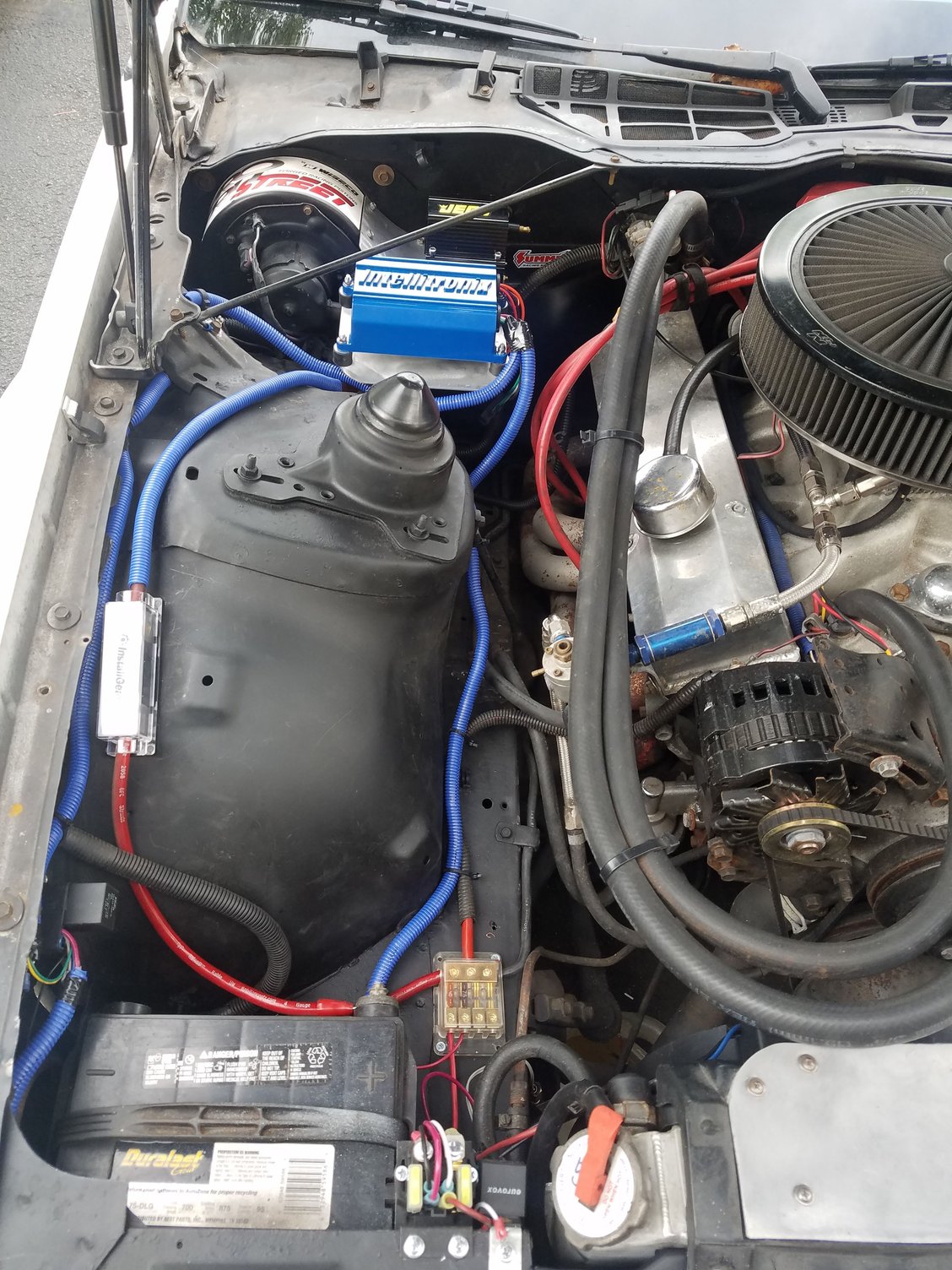

On the car itself i removed the AC/blower box to replace with a non AC one, cleaned up some unused wires, now just got to wait for the shorter blower wheel and a new resistor controller from Rock Auto...They are pretty fast on shipping stuff but i hate waiting.

That's not gonna work

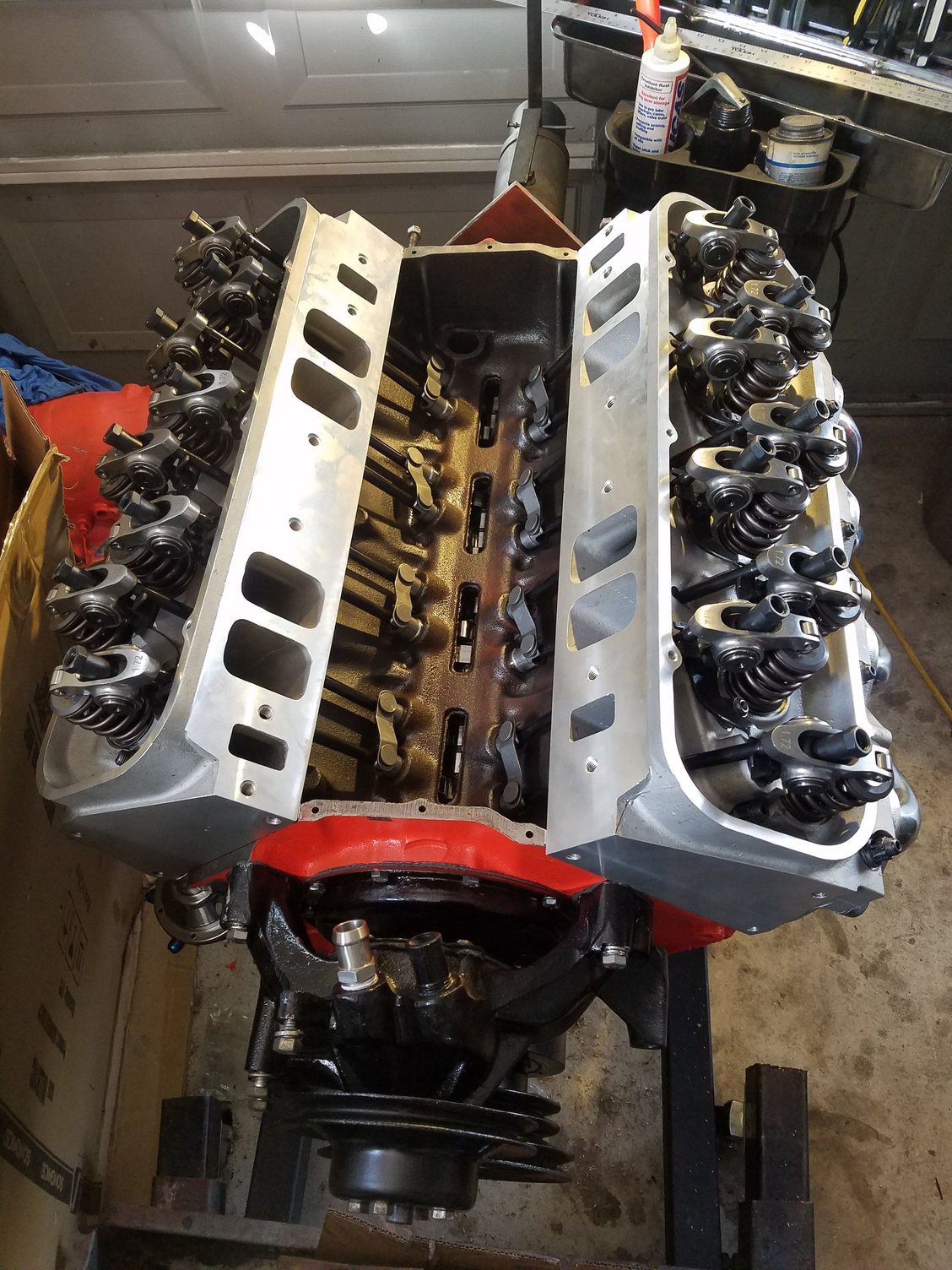

Starting to look more like an engine
If you look at the roller rocker i was testing with a small block push rod and it is just a tad short on the intake side, in a bind i would use it.

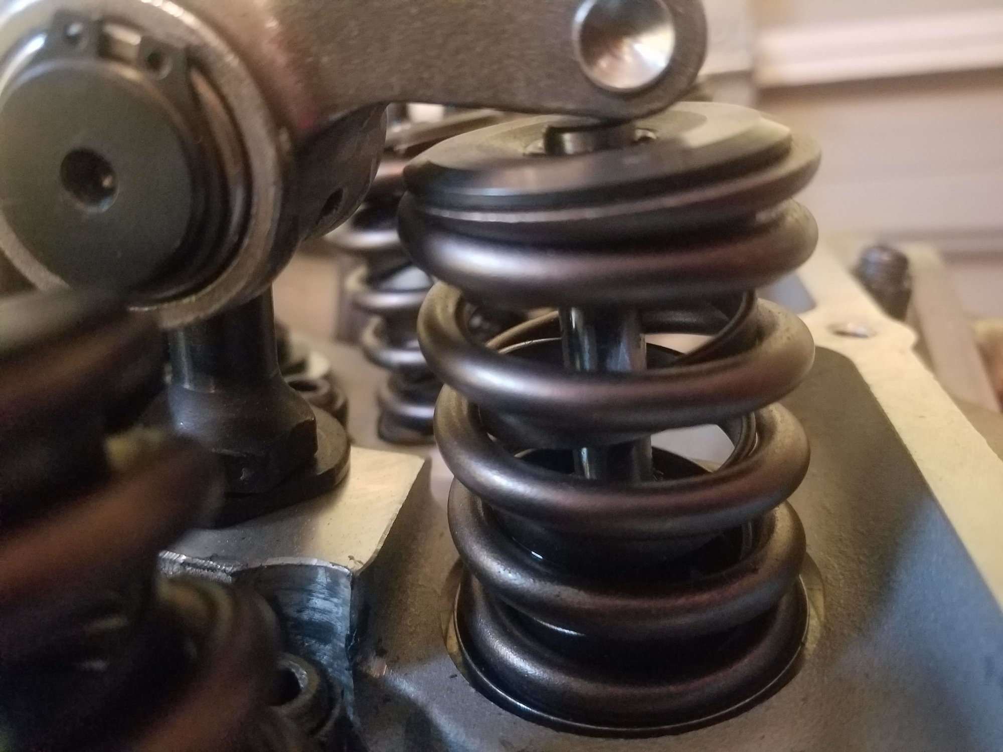

Finally got all the correct parts for the valve train, got a great deal on the titanium retainers, saved 11 grams over the chromoly steel ones.
Replaced the AC with a no AC box, mounted the coil and ignition controller, cleaned some more wiring, i'm not crazy about the blue wire loom
