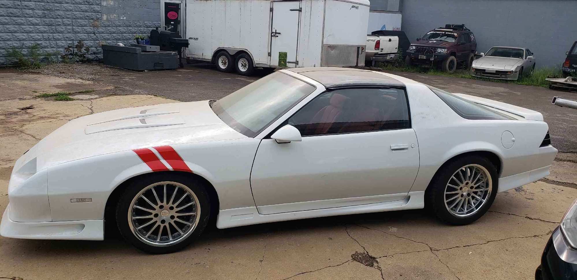

She got a makeover....L03 gone.....350 carbed in....what hp do you guys think it is?
Fresh pro topline 083(i know probably a mistake)
Xe268h comp cam
Flat top pistons....9.8to1 compression
650 dp quickfuel
I was think 320/330hp flywheel...am i close?
(Will be putting wheel spacers and bigger tires up front)

I think it will do 300 to the flywheel. Same engine with stock cam was once rated at 285hp as a crate engine. I've saw stock L98s when swapped to carb immediately get in the 13s simply because they were able to breathe to 5500rpm. I'm soon to drop one in my car with a beefed up TBI and I hope it doesn't hold it back too much.

Thanks for the reply.... i was hoping for more.....i guess a set of heads will be on the wish list!

I'm curious to see what it turns in the 1\4. I may be a bit conservative on my numbers. That car should run really good and may surprise you. Real nice job you've done with it. Keep us posted
