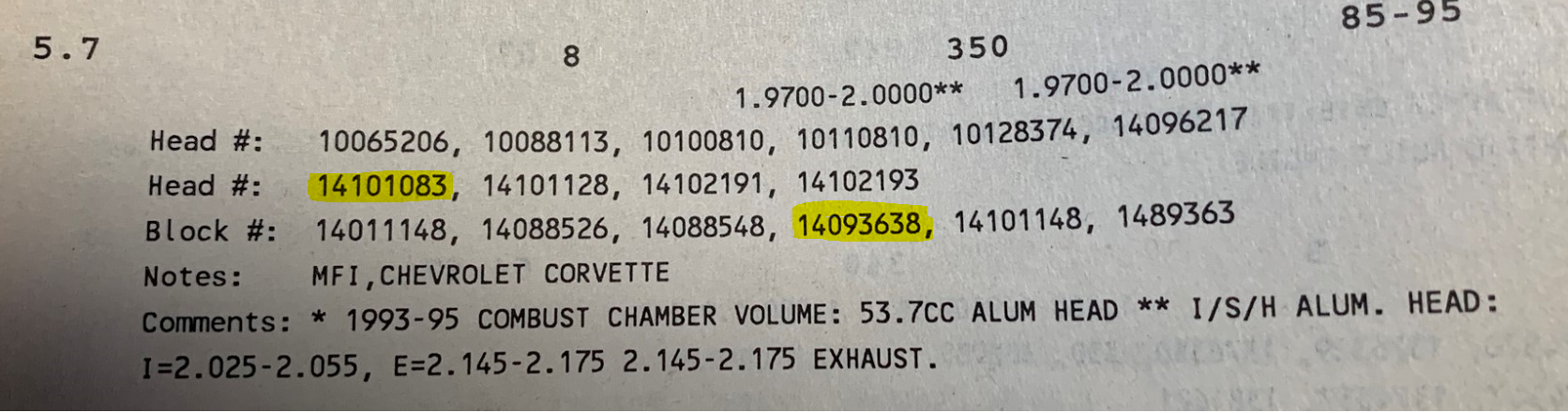

My local machine shop had this in their book:
I highlighted what I understand are the stock L98 casting numbers. I have also read to be careful that some 350 heads are restrictive. I am hoping to locate castings that will work as well as the stock stuff, if there are any. The machinist said he found the short block, but only a set of "175" heads which do not appear to be listed.

083 heads should be around. I'd call some of the bigger engine re-builders and have them check their inventory. Places like Coast Motor Supply.
I was going to use these heads if I could not find 083s, as they are similar/maybe better than stock. Has internal EGR passages so smog friendly. https://www.ebay.com/itm/VORTEC-HYBR...T/171430638393
