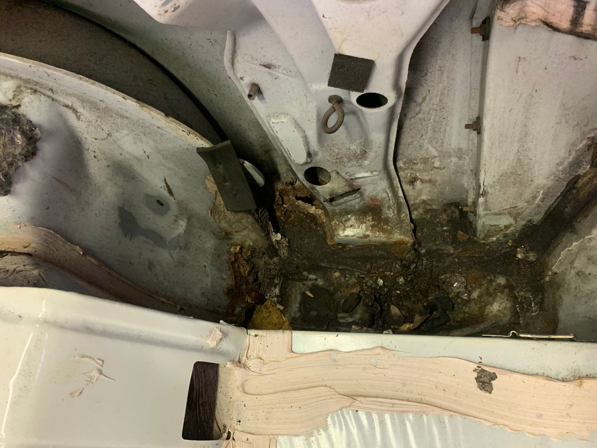

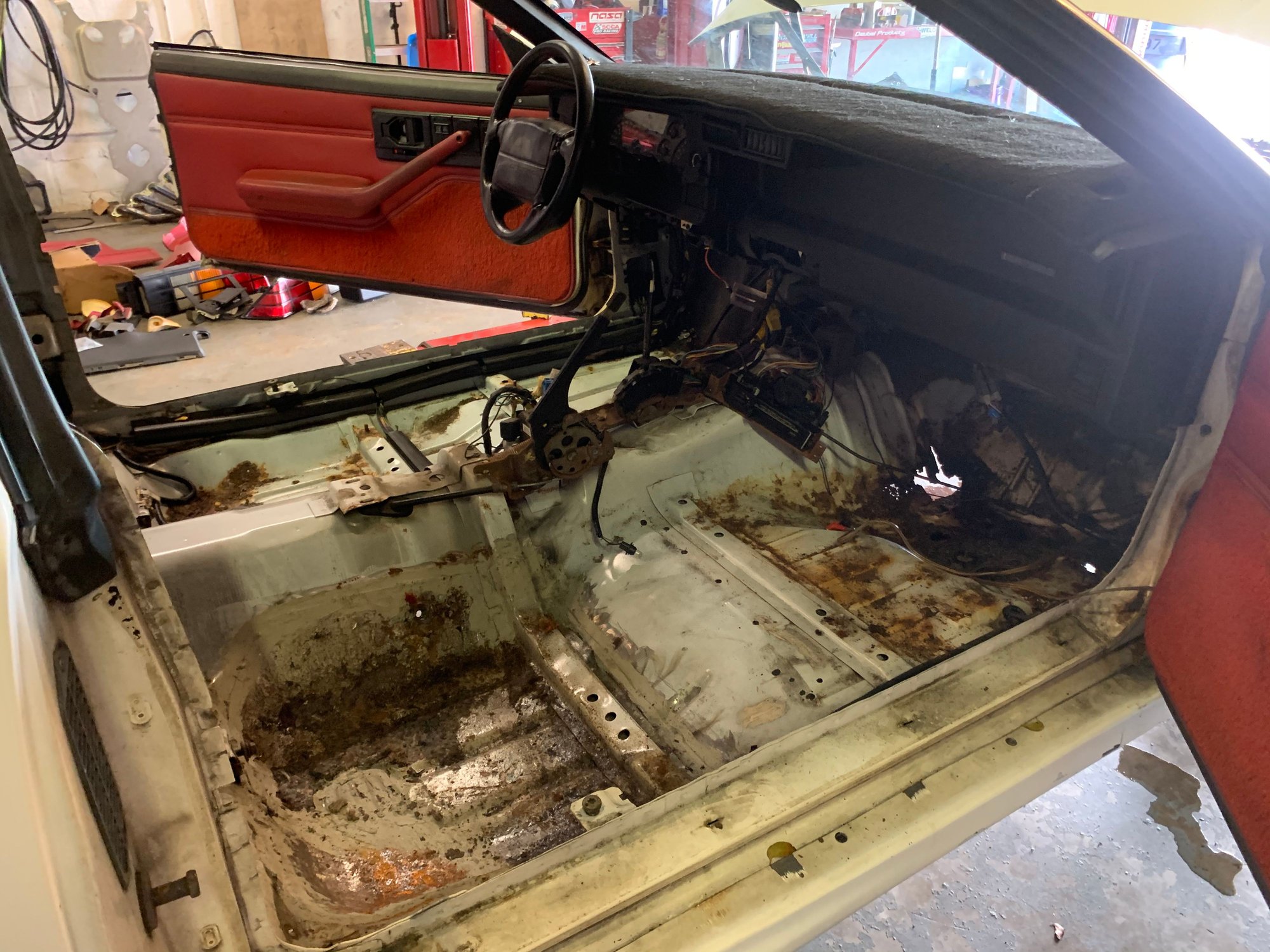

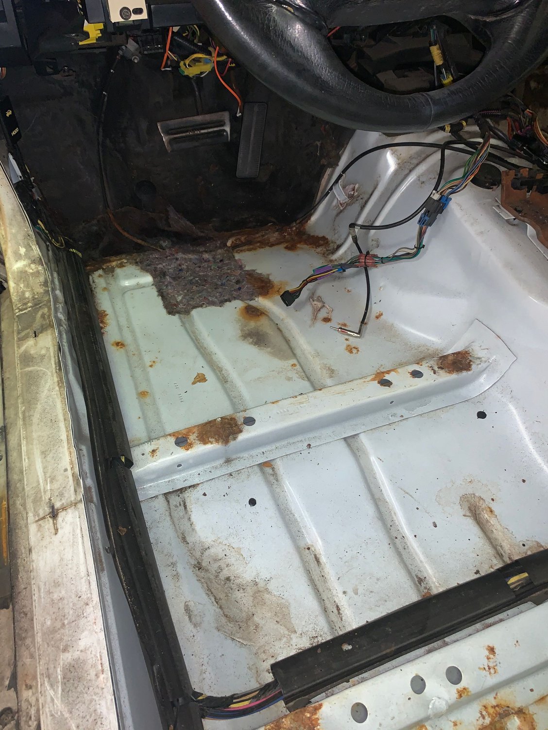

Ive stripped the interior to inspect how the floors / roof are doing and found some expected but unexpected problem areas.

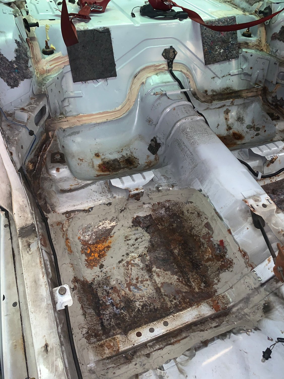

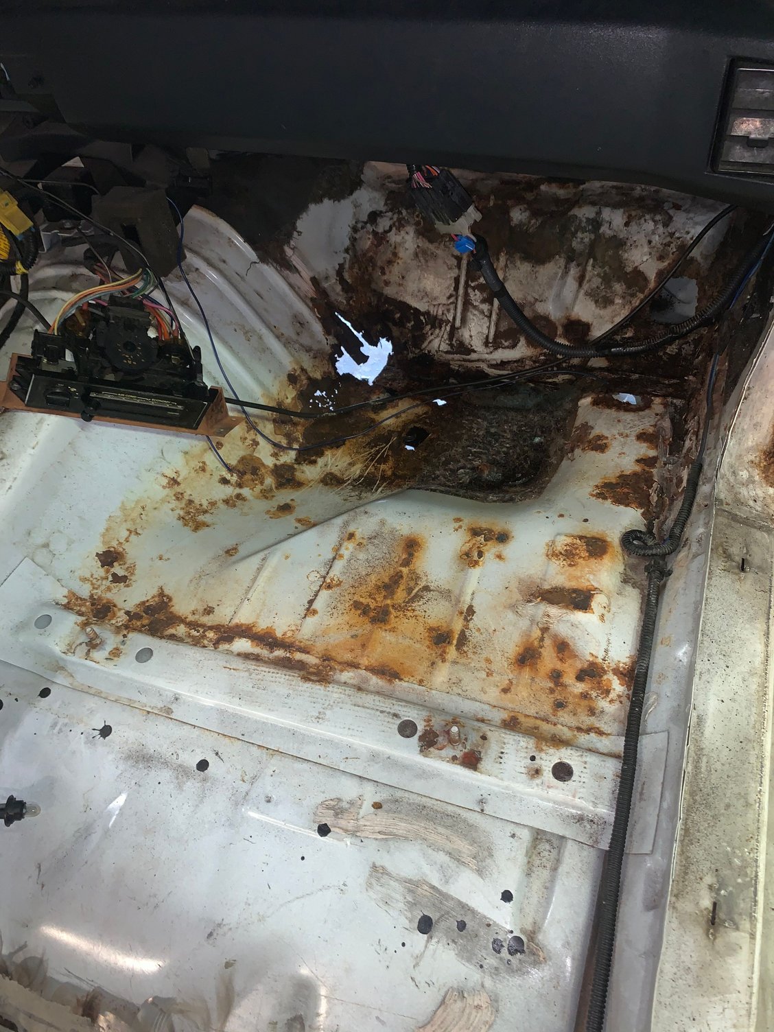

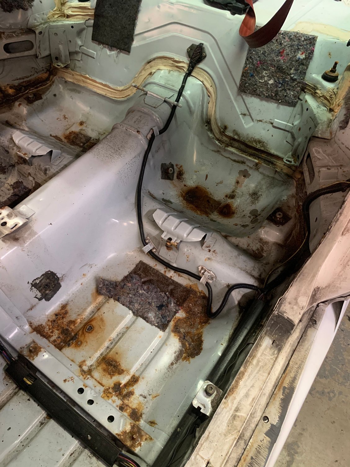

Passenger rear floor pan has been replaced before (not in an acceptable way imo) so I’m going to re-replace the passenger side front and rear panel. There’s a area right next to it, the kick panel area, that needs some help too.
Driver side is decent, besides the rear area. Not as bad as the passenger side, which is good.

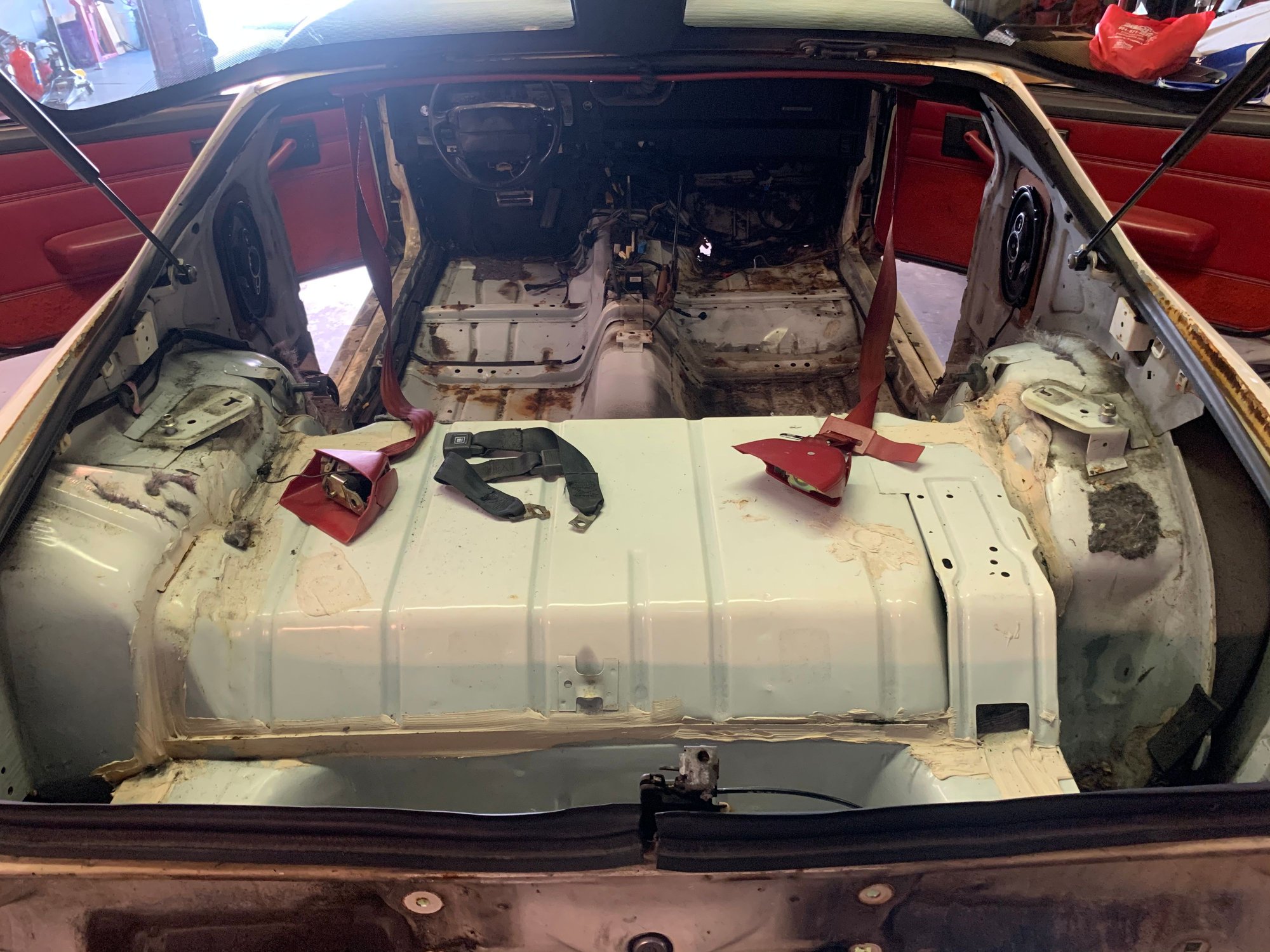

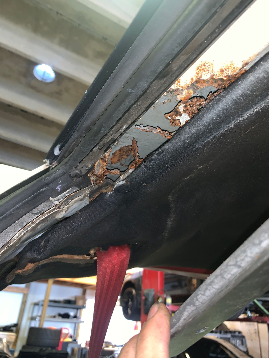

The roof needs some repair on the passenger side near the B pillar, don’t know if I should have a full roof put on yet or what. There may be a 4-cage installed so I’d be able to do a complete weld of the tubing if the roof is removed and replaced.
Lastly, there’s a rear quarter lower area that needs to be replaced along with a small area of the wheel well. Not too worried about that one.

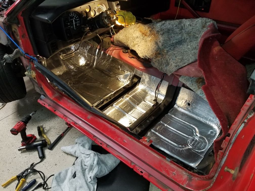

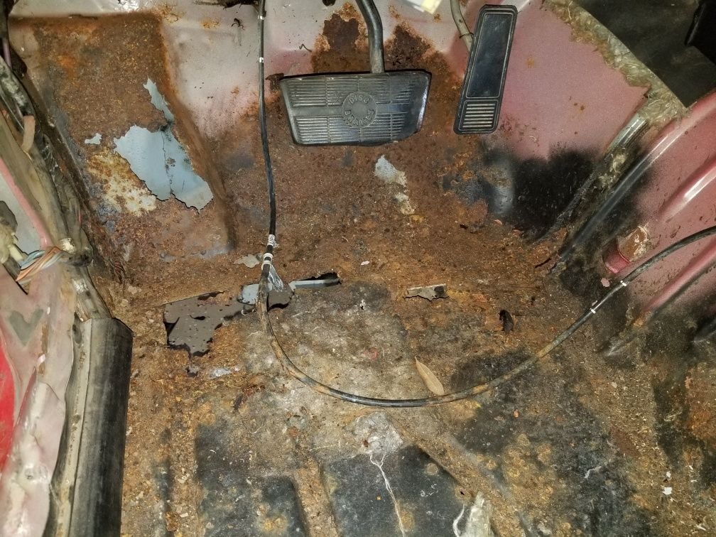

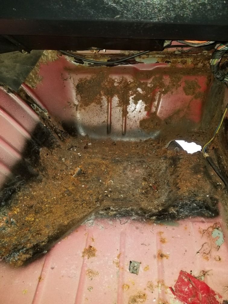

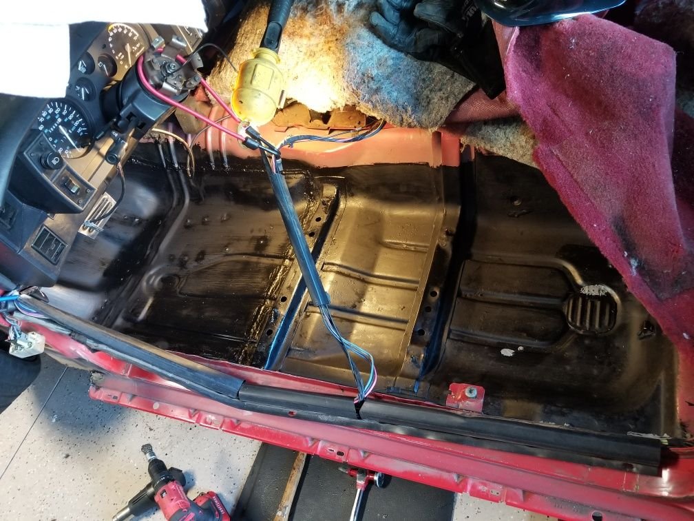

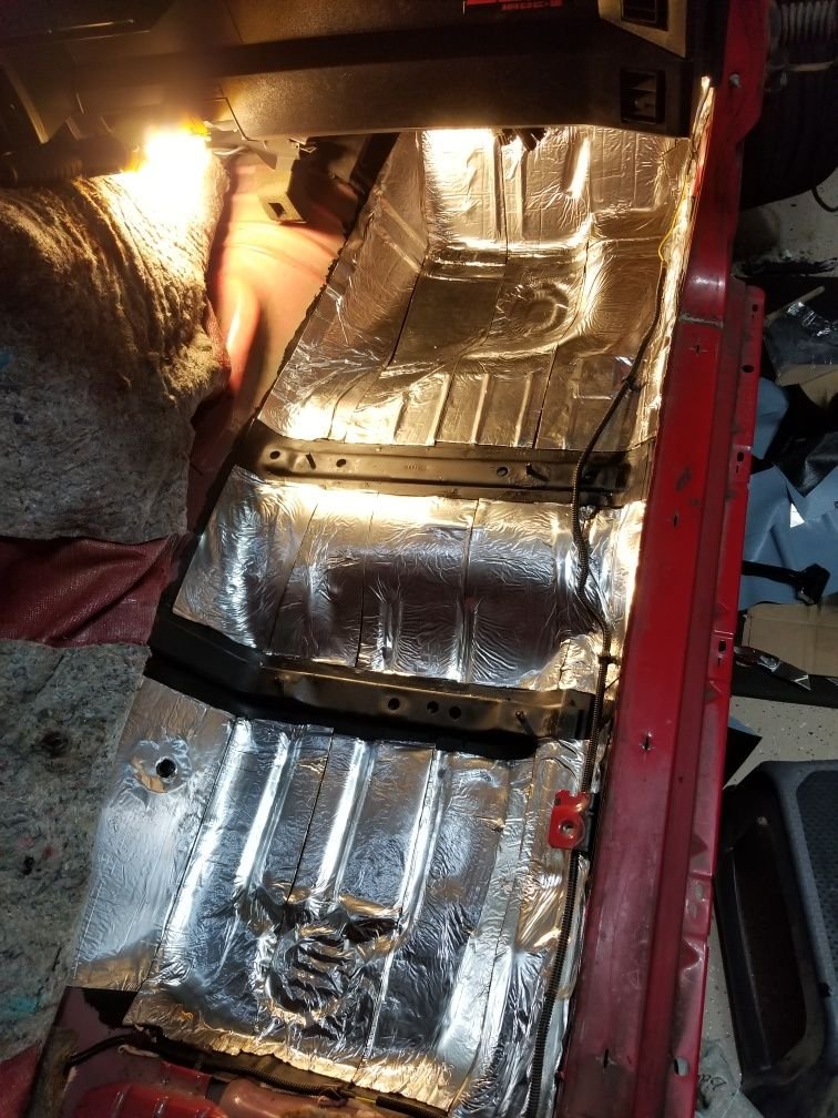

Rust doesnt look that bad compared to what I had to deal with on my 87 Iroc. Rust in the usual spots.
Before pics
After replacing front section floorpans, painted with POR15 and lined with "Home Depot Dynamat"
