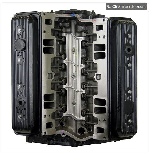

I'm not finding much luck on Summit or Jegs. On Summit, for example, I can only find this 350 for a 91 Z28.
https://www.summitracing.com/parts/v...t/model/camaro
It's $1800, but I'd have to install oil pump, pan, and timing over for it to be an apples to apples comparison with the Jasper Engine. BUT this one is a remanufactured engine. So I just wanna understand if its OK... and if there are any other options out there. Also, what's so bad about Jasper?

So the linked engine from Summit is an exact replacement engine for a '91 Camaro. If your car originally came with that engine and you were simply replacing it then that would be what you would need. Pull the old motor out, switch all the stuff over, drop it back in, set the timing and you're done. However you didn't have that engine from the factory, so you're going to have to re-tune the ECU in your car unless you replace your engine with a 305 like you have now.
If you're looking to go to a 350 then you're obviously trying to get more power, so basically you can install whatever 350 you want as long as your current intake and accessories will fit onto the new engine. If you want piece of mind don't buy a re manufactured engine buy a new one, but if you don't mind a reman then go for it. Simply put, any gen 1 small block will drop right into your car and be OK, but unless you put in the exact same engine you're going to have to tune the ecu.
As for my Jasper comment, I talked with a friend that bought one and the motor didn't last more then a 1000 miles before it died.
I am personally installing a used 75,000 mile vortec 350 out of a 1997 tahoe in my '87 IROC and all of the factory accessories have bolted right on, my T5 trans bolted right up to it, it fits in the car perfectly, and it looks factory. The downside was that I had to buy an Edelbrock vortec tpi intake base that cost $400 to make the tpi setup fit. I am now into this engine for $1000 which includes the cost of the motor ($400), intake ($400), water pump ($50), starter ($100), and gaskets ($50). When all is said and done it should be in the 275-300hp range for power, where the 350 in a '91 camaro put out 245hp.

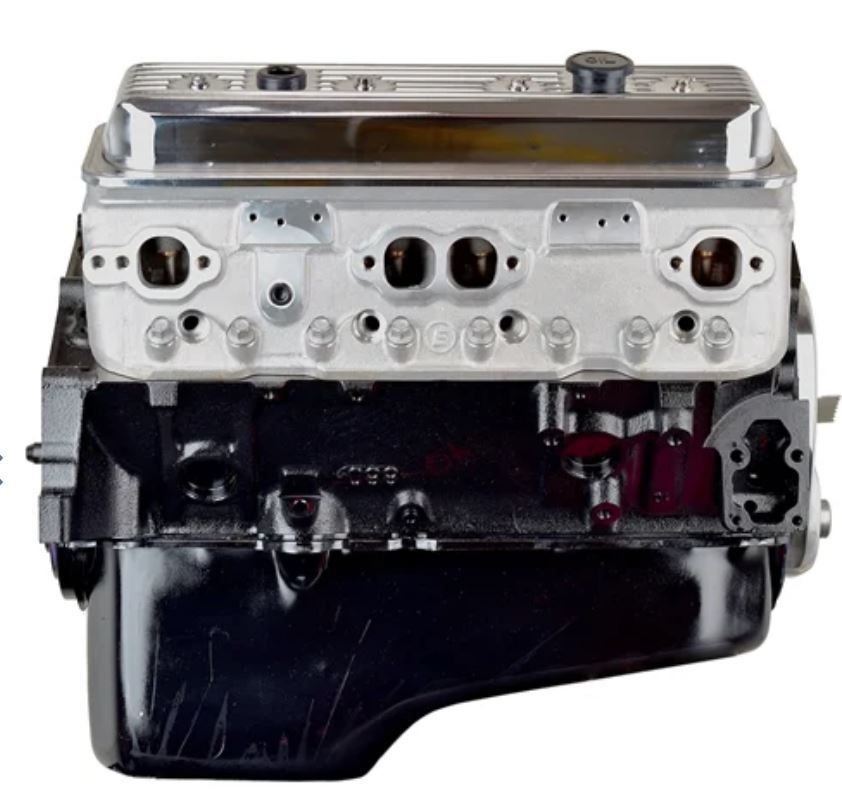

Honestly, I'm currently in the camp where I'm willing to shell out $2k - $3k for a new crate motor like maybe something like this:
Jeg's 350/290 Motor
But again, I am not entirely sure if this will work with the existing TPI intake, accessory brackets, and misc sensors that go into the block/heads. When I eye-ball the picture, it looks like everything is in the right spot... but I am not sure if I'm missing something. And I would hate to buy such a big ticket item just to find out that my brackets don't fit!
And yes, I totally get your point... ECU tuning is required in a conversion like this. I will be investing in a programmer setup as recommended on the tuning section of this forum. I am also hoping to ask around my area and see if anyone is proficient in this process and would be willing to pay them to help tune my engine.

Ha ha yes there are a TON of different small blocks out there, but here is the quick and easy on chevy motors that will concern you. Your factory accessory drive setup, TPI intake, motor mounts, and transmission should fit almost any 350 up to 1996 when the Vortec heads were introduced. If you choose to go with a factory vortec engine then the only change will be the lower intake manifold, the rest of the stuff will bolt on. Vortec heads flow a lot better then the earlier ones, but the intake bolt pattern is different. There are only eight bolts on going straight up and down on vortec heads (two in the front and two in the back with none in the middle), compared to the twelve on the previous heads (two in the front, middle, and back) that were at an angle. the reason is that the coolant passages in the heads are only in the front and rear on the vortec heads. Top pic is the non Vortec and bottom is the vortec.
Regular sbc head
Vortec head
The other benefit of going with the top motor is that your valve cover choices are way better once you get away from the center bolt verity.

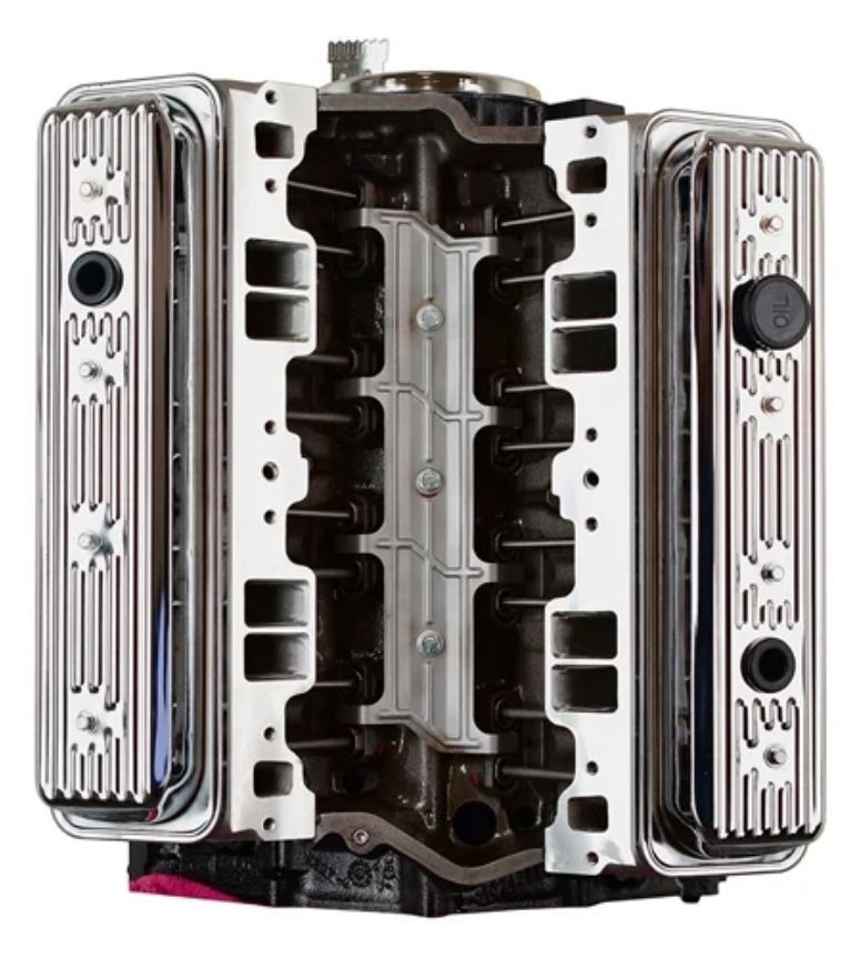

So according to Jasper's website they sell a L98 which they label as the "police package". I'm assuming that if I went that route the intake could drop in... but the tradeoff is it would be a ~210 HP engine versus trying to find an adequate crate performance motor around he 300 HP point. And ya... I wouldn't get the core charge back.... so the Jasper engine is $3k.
I totally get everyone's point about re-using the factory TPI... so I guess I should clarify my plans... I really am just saying that I want to keep fuel injection... not necessarily the stock TPI intake setup. I am ok buying an aftermarket fuel injection setup as long as I can keep all the electrical connections the same. So maybe something like a Weiand Stealth RAM that says they can handle the two different angles of center bolts (requires an additional kit for 1987 and later cast iron heads).
So if I wanted to buy an aftermarket EFI Intake and a 350 crate motor running around 300 HP... what options are there? It seems like so many crate engines are for Carburetor intakes... and I'm just trying to make this engine swap the least painful, simplest install, small nudge of performance increase, AND without spending more than $4k for everything. (I'm targeting $3k for engine and $1k for intake)

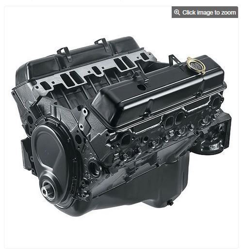

One other thought I had was trying to search for the same year Corvette Engine. So a 1991 Corvette C4. When I search for that on Jegs I found this, which basically is saying you can use the stock TPI intake and it will be a 289 HP engine. Thoughts?

I had an ATK reman LT1 in my 1996 Impala SS develop Combustion products in the cooling system after about a year. When I telephoned ATK, I realized their warranty was nothing!

The best source is a Chevrolet Performance crate engine.
Otherwise just get a used Vortec and freshen it up with a basic rebuild and a cam.
