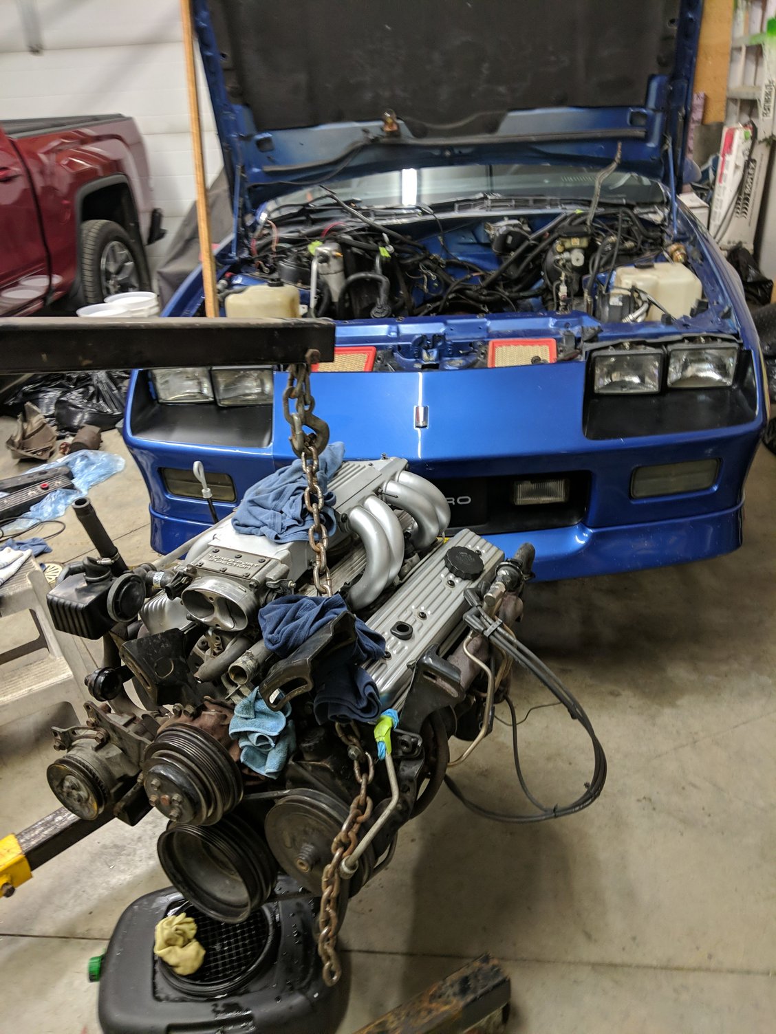

I bought my 1987 Camaro last August. It seemed to burn a bit of oil and had the normal blue puff of exhaust on start up. At the time I didn't want to swap the motor but I did a compression test and found 90psi in cylinder 5
I took it out and put new rings and bearings in and then tested compression again and got 90psi again.... Well it wasn't until I did all the work that I found out the compression tester was bad.. 😣. It still smoked on startup so I said screw it, new motor time.
I wanted to get it in by the end of last summer but parts were back ordered for 6 months.

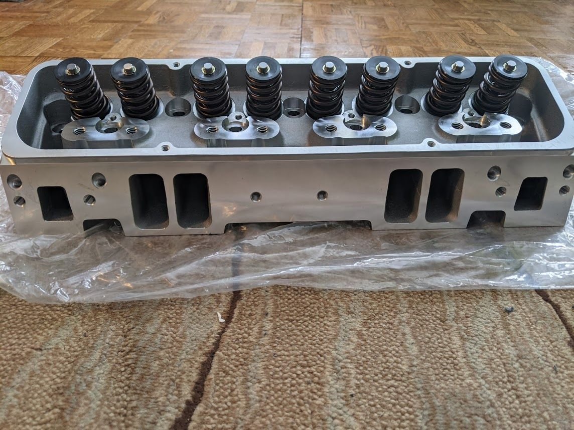

What I settled on was:
1997 350 roller block bored .030" over
AFR 195cc as cast heads
Comp XR269HR with 1.6 rockers

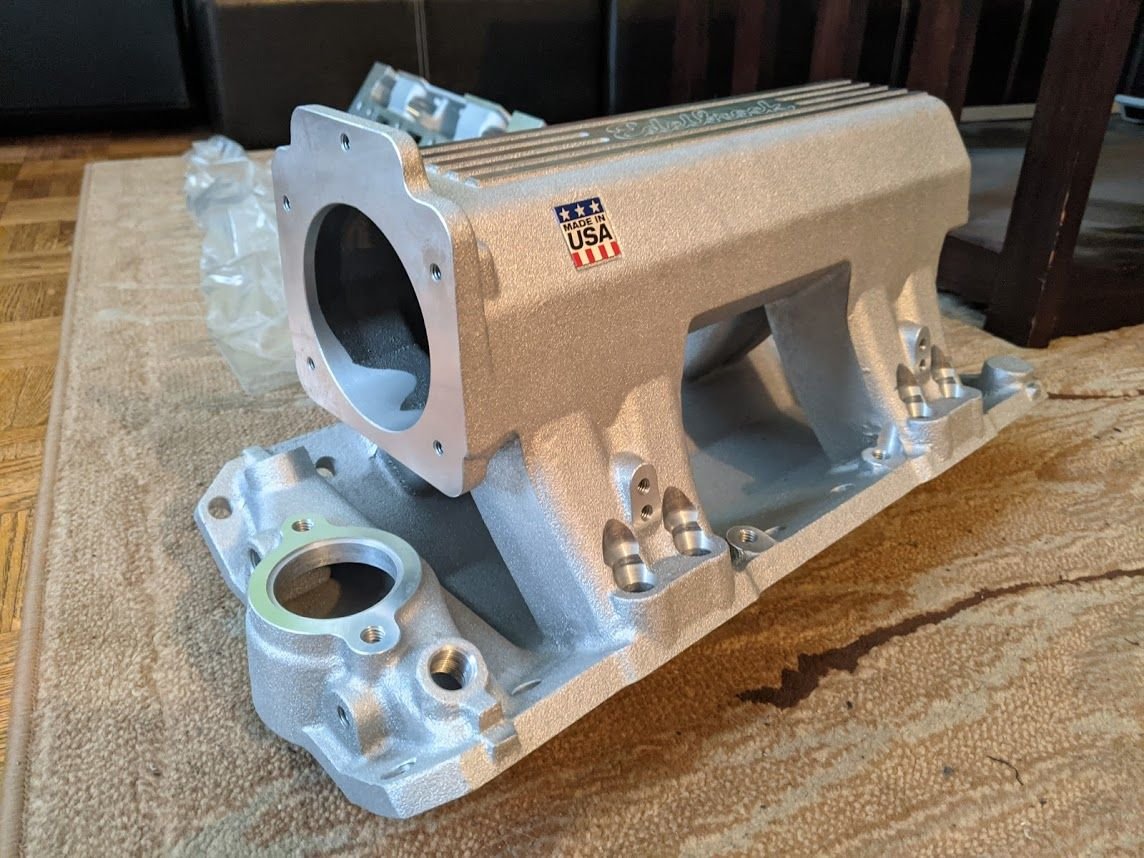

Edelbrock Pro Flo XT 4 efi intake. I wanted HSR but was out of stock and every month the shipping date got pushed back a month.
I've got the 383 in and slowly hooking up components and fabricating as I go along.

I originally wanted to use a HSR intake but they were out of stock for 6 months. So I settled on the Edelbrock pro flo xt 4. I had to modify LT1 fuel rails and built a TPI throttle body adapter plate. I also made a bracket for the throttle linkage.

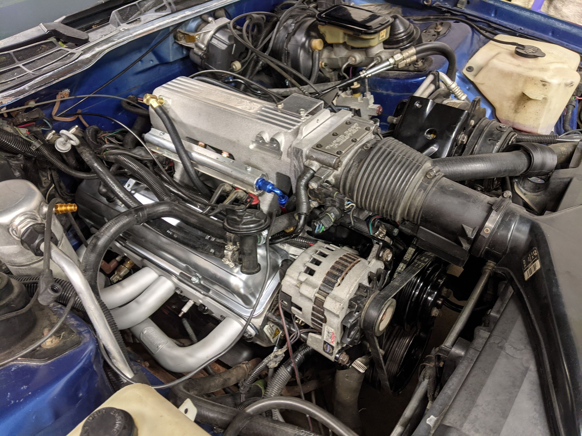

It's alive!

Old Jul 24, 2021 | 07:18 PM
NoEmissions84TA's Avatar
Joined: Feb 2017
Posts: 4,185
Likes: 576
From: Meriden, CT 06451
Re: 383 build/swap
How is this intake gasket supposed to work?
Old Jul 24, 2021 | 07:47 PM
89fast5oh's Avatar
Joined: May 2012
Posts: 705
Likes: 95
From: Manitoba, Canada
Car: 1987 Z28 IROC
Engine: 6.2L
Re: 383 build/swap

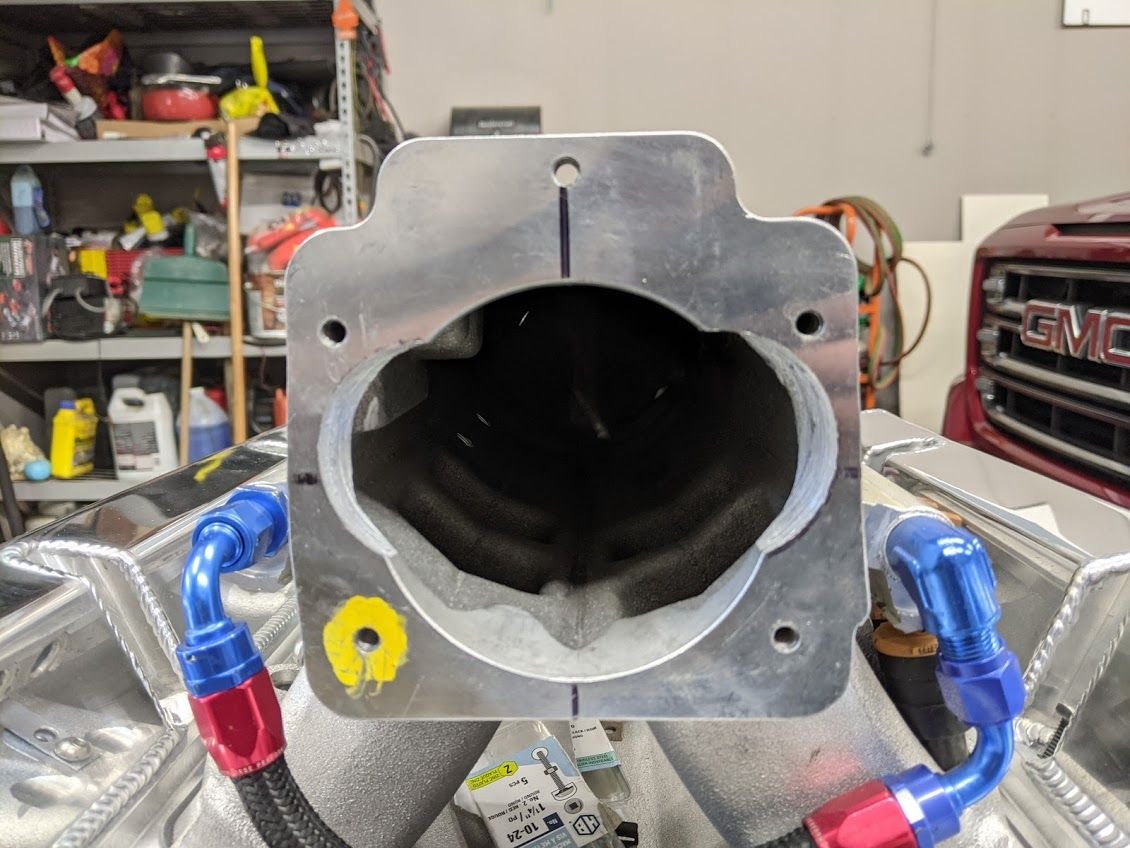

Does the Pro Flo XT 4 manifold clear the hood? I was looking at it for a Firebird build but it seems "iffy" on hood clearance. Did you consider using the Pro Flo throttle body?
Old Sep 8, 2021 | 08:55 PM
  #48
89fast5oh's Avatar
Joined: May 2012
Posts: 705
Likes: 95
Car: 1987 Z28 IROC
Engine: 6.2L
Re: 383 build/swap
Yes. With the stock under hood insulation there was over 1/2" of clearance. Pro Flo TB was too much $ for me.
