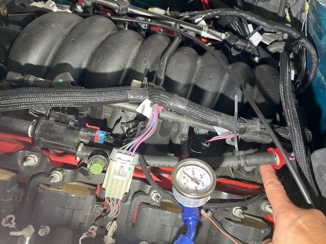

In performing the LS1 swap into my '91 3rd gen Camaro, can someone tell me where the rearward end of the "vapor tube assembly" connects? See where I am pointing below. Does it somehow connect to the PCV ventilation pipe? If so, please send a picture. Thank you!

No, that goes back to the whole evap solenoid / canister / whatnot arrangement near the gas tank. All of that might or might not have made it to your car during the swap.
