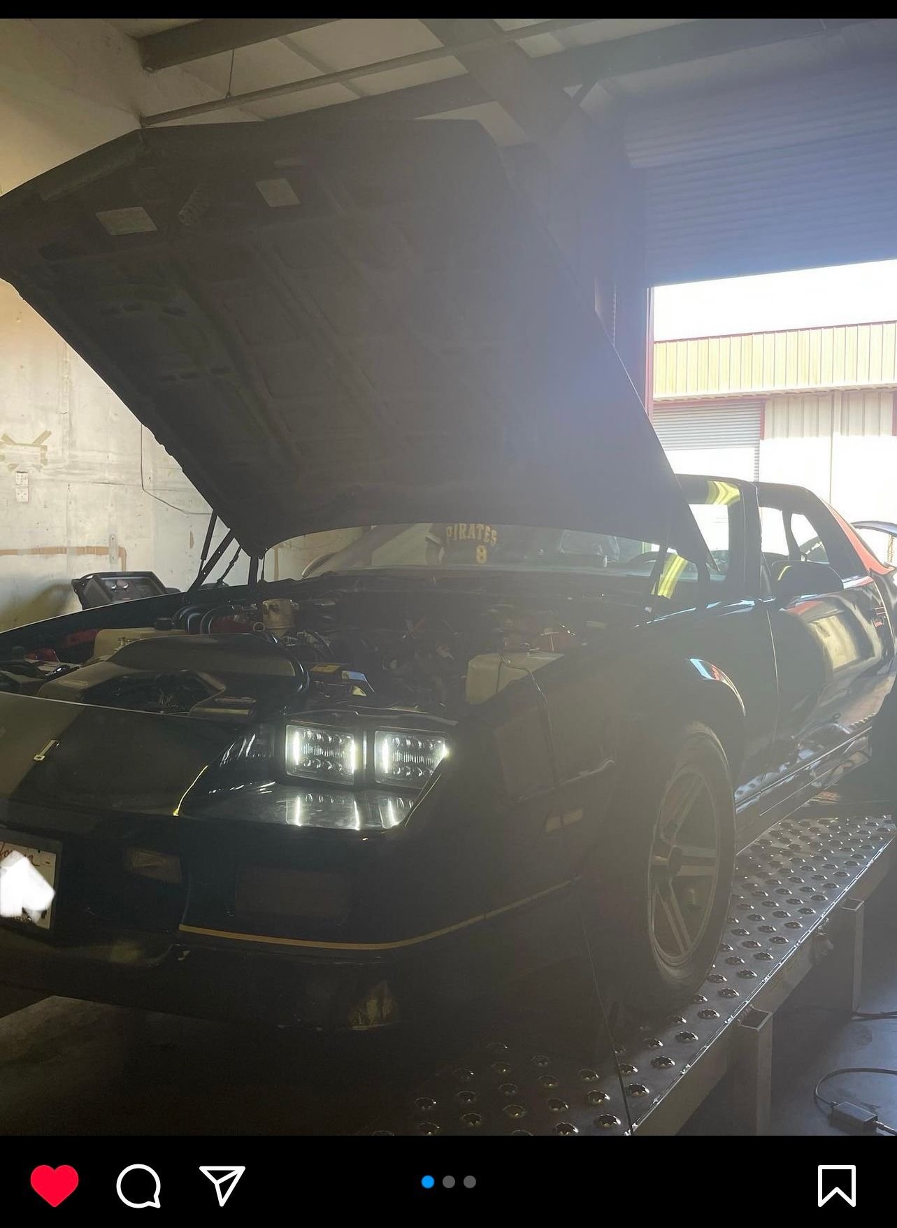

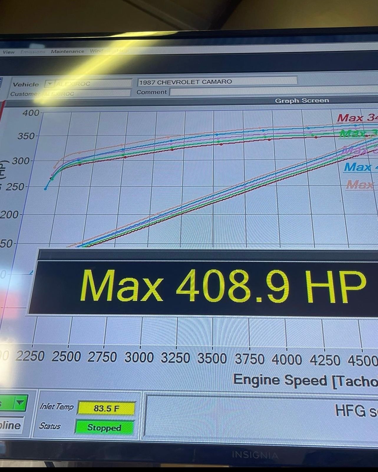

Hello all,
ls1 swap done by yours truly. Dyno tested today… I’m happy with numbers but tune guy says restriction at TB and MAF. I want the stock look (as if GM made it)… what can I do about the MAF and TB to get less restrictive?
thanks in advance.

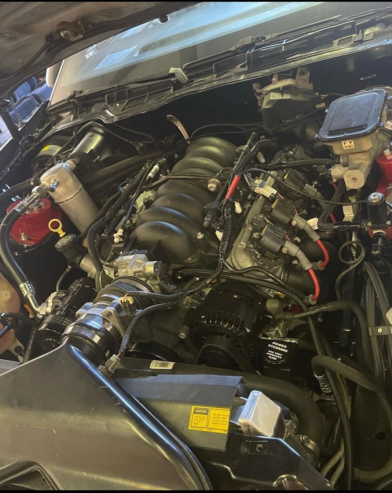

Custom front lid. Can increase size slightly but requires some work. Some guys have done it. Maybe worth a few hp on that deal, but I wouldnt worry. If maf was a problem you could delete it and run map sensor only but its working so i wouldnt
ideally you need 3.5-4” intake tube but that wont work with the tpi lid
You could duplicate Chad's example in the link below.
https://www.thirdgen.org/forums/fabr...ir-intake.html
There's also this older thing that follows the same theme.
https://www.thirdgen.org/forums/tpi/...pi-camaro.html

Had the TPI intake track discussion with Hawk's Motorsports when my 91 RS was resto-mod'd in 2015-16. They said using the TPI intake track was an easy way to lose ~30+ whp on a healthy LS1/LSx etc in their testing.
Hawk's has an intake tube set up, maybe for thr GTO, can remember now. That works well and looks decent.

As others pointed out, that intake is the restriction. It appears your set-up is on the stockish side which would mean your MAF is probably not the issue.

Word is that these clear the stock Camaro steel hood.
The early Z28 fibreglass version has to much bulk up at the latch to fit the TPI filter case (in case anyone reading wants to try it on an 82-84 Z).

I can tell you the stock Y with bottoms cut out and ducts run for ram air in the grille did not hurt my 400 whp 383 vs a custom 3.5” CAI with 3.5” maf
