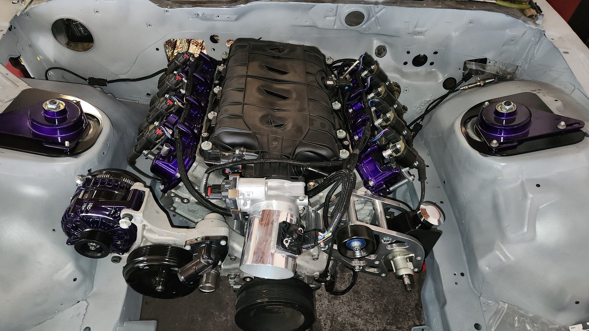

Hello everyone, I am currently working on an 85 Firebird. I am doing a genV Lt1 (L84).
I'll get my recent and current progress pics on the thread for you guys. Hopefully I can get some input when needed..
otherwise I'm just building and enjoying.. Any socal locals to link up with in the IE.

Looking Great so far!
I am not and fan of the Gen-V SBC Platform...
But I very much like the effort and the swap process!
What color Powder did you use for the Purple?
Who's Alternator are you using?

Re: 85 Firebird Resto/LTX build
Yeah I wanted to go a different route and not just put an LS.
Powder is illusion purple, there's black and some hidden nardo grey pieces.
the alternate is autotech engineering, with some high output pieces in it just to keep it running nicely.

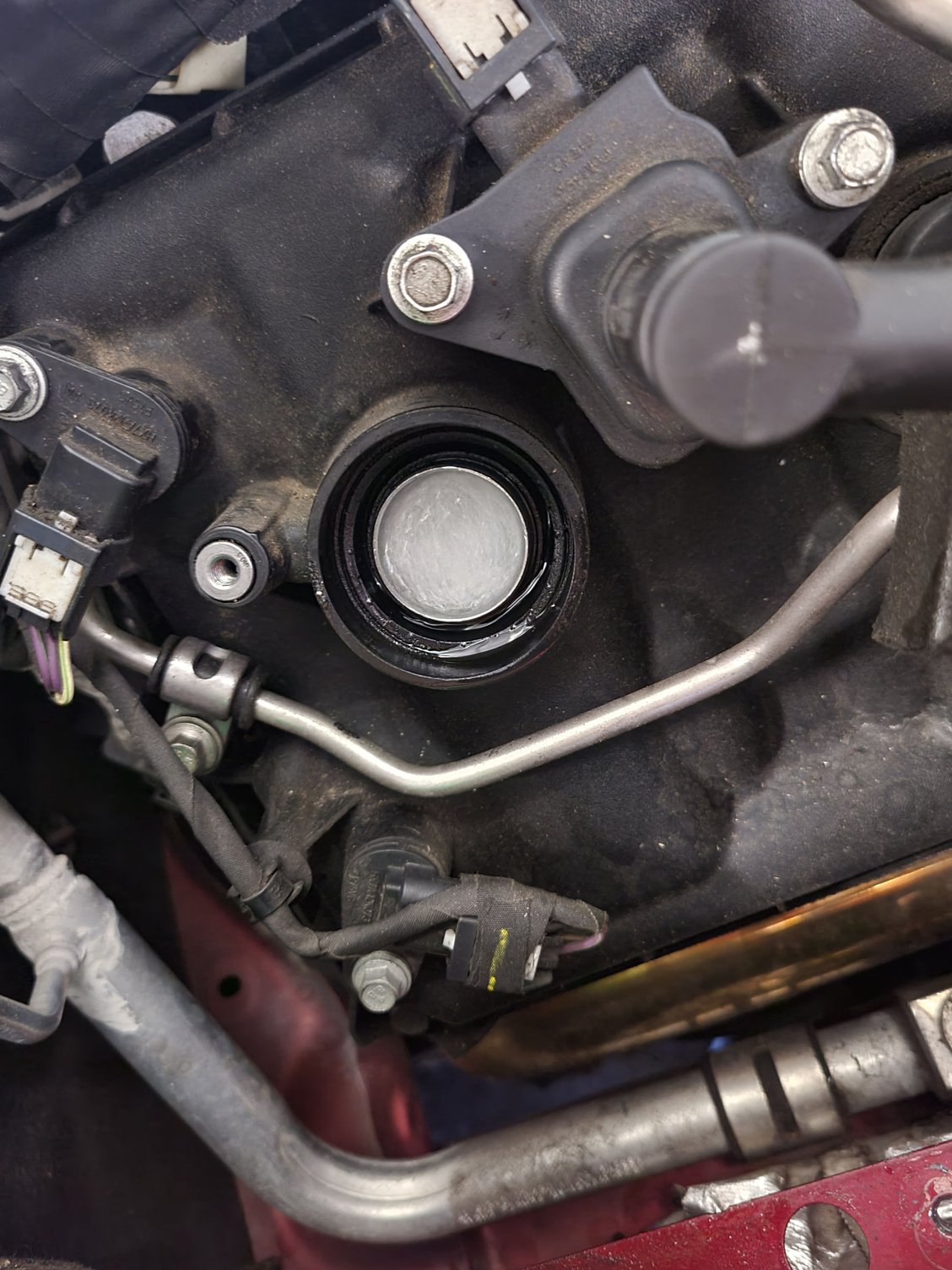

Ok, I have hit an issue. The engine runs. Yet after like 6 seconds, it gets a knocking sound.. Now I am getting an injector 6 circuit code. Yet would that bring about that knock? It hasn't been ran long enough to find out any issue.
What I have done though is I removed every spark plug and switched the starter and the engine rotates freely and sounds free of any issues.
I opened my intake valley to double check but I have no DOD solenoids only MichiganMotorsport plugs. Seen no issues cam looked fine.
I opened the valve covers and found no broken springs no issues in the valve train.
Could it be the issue at injector 6 is where I'm currently at. Yet sound seems to come from possibly the driverside.
Now oddly the cars starts and runs sounds fine. Then it knocks. The motor has 7 miles on it. Nothing more then the solenoid caps and an oil pan.
Could it possibly be the tune and the fact I don't have my cats and 02s installed yet?
But I don't see that being the issue unless it's a specific thing it needs to see to know.

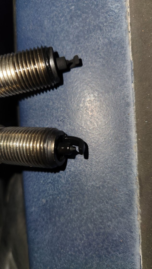

Yeah I pulled them and it had carbon fouling on them. Gonna check for fuel though but you know what. It's outta gas I think lmao

Yeah I pulled them and it had carbon fouling on them. Before that you know what. It's outta gas lol

Ok here is the update. First, I pulled the harness and did a continuity test s t between all the injector plugs to the main connector, I found 0.03-0.04 across all of them.
Decided to swap injector 4 to cyl 6 and vice versa. Start engine and at first nothing but battery is low engine dies. I keep firing it up a bit with cylinder 6 disconnected and it wasn't knocking. Did it with cyl 4 disconnected to see if it's an injector issue. It knocked.
So I do a few more turns of starting then pull the plugs
Wet plug in cylinder 6. Both look pretty black but thats direct injection.
Cylinder 6 is wet and 4 was dry.
Then I pulled the other 2 no pick they were dry. Yet then I pulled 1-3-5-7 and they were all wet
Sorry these photos were trash but they were all wet
So I already know it has enough fuel pressure, I'm beginning to believe it's in the harness since it's an injector circuit A code.
Turned the motor over for a while to make sure it wasnt an oil pressure issue. Which it turns beautifully and even though the tone changed slightly as it built pressure. It wasn't the cause.
