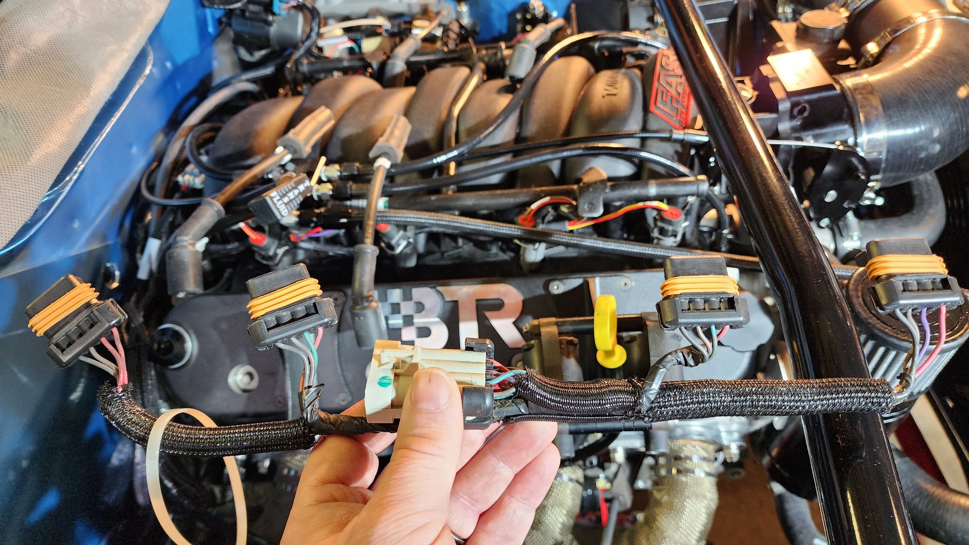

Just wanted to give an update. I figured out my backfire issue with cylinder 6 & 8. Had the freaking coil harness on the passenger side on backwards. I looked up the wire diagram a couple times and still missed it. This picture is how I had it and wrong, I just had to flip it.

Hell yea bro! Glad you got that figured out. Fire it up already
