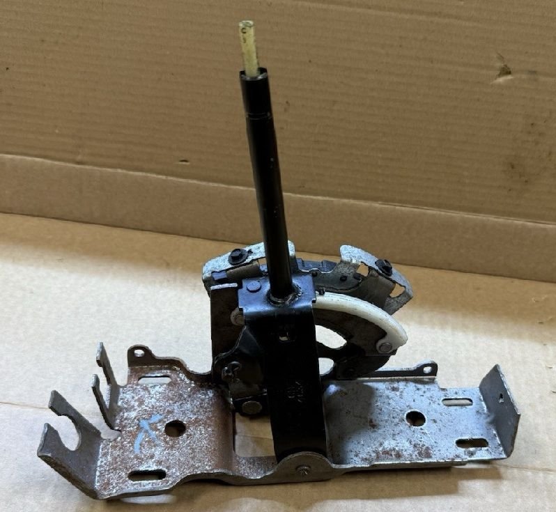

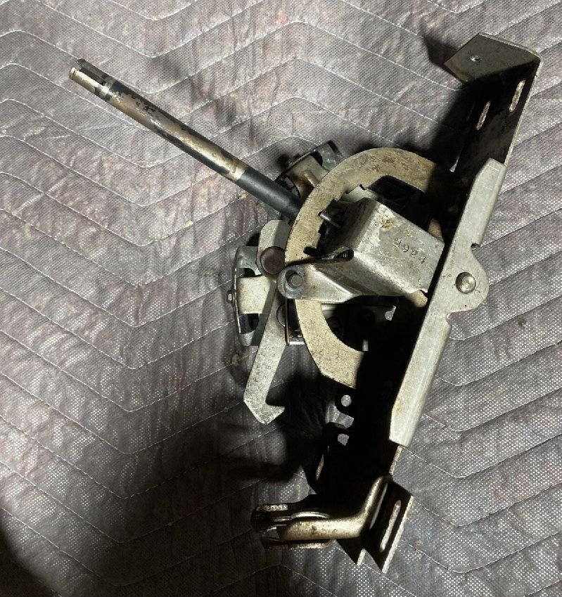

I should have posted on here before I bought the shifter lol. Those pictures very clearly show my problem. So now I need to try and find a shifter from an 83. Awesome .
