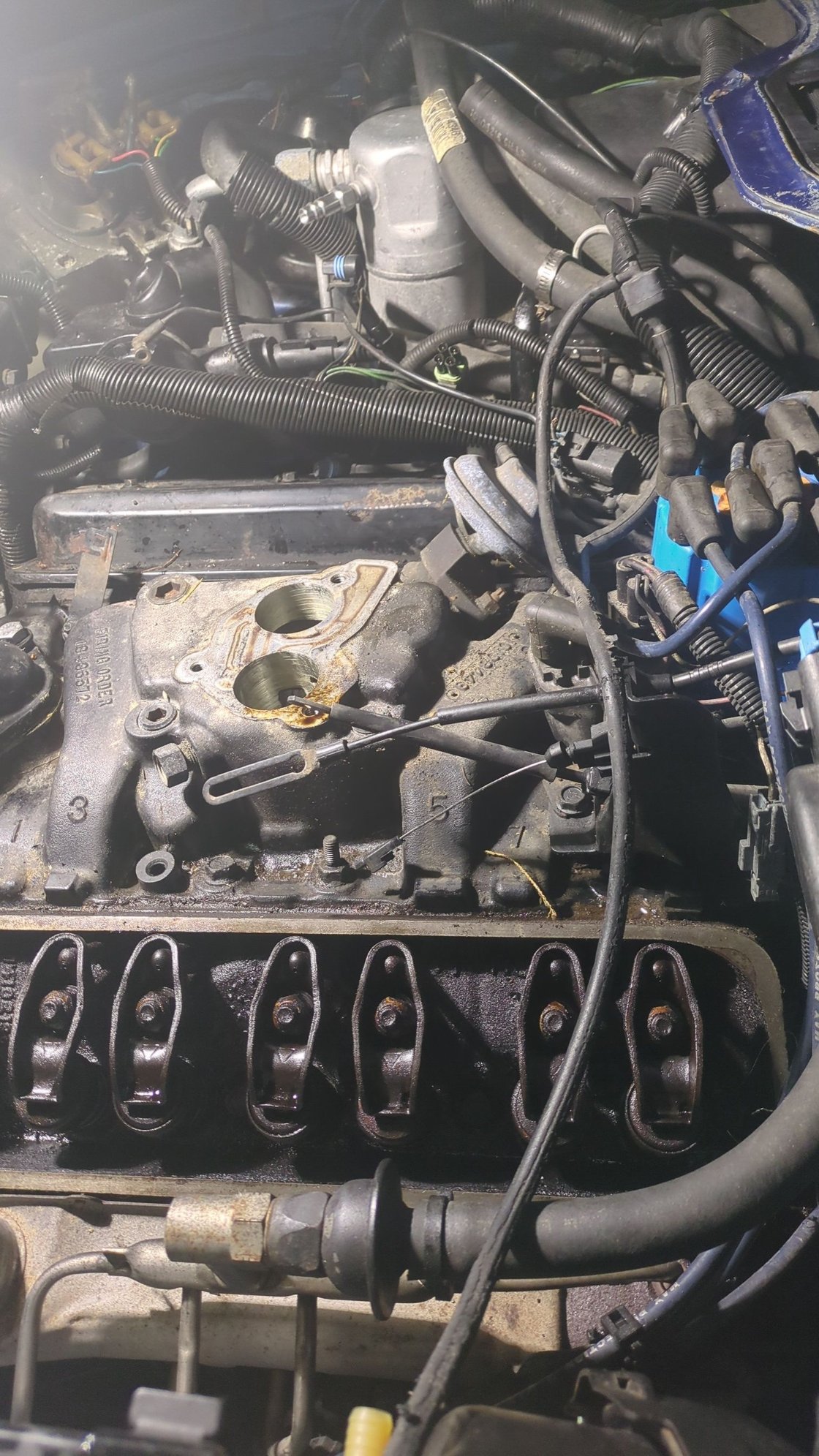

Classic 305-350 vortec swap so I bought this 350 from a salvage yard and have not a clue what I'm doing it's from a 1999 Chevy 1500 Questions I have:
1.Can I use this carburetor even though the connections and cable on it is in the reverse location as the car?
2. The fly wheel is much larger will I have to use the old one?
3. What are all the side connections and how do I deal with them?
4.the new intake manifold has a large connection for something right in the middle that was not on the old one what do I do about that?

  1. There's no "carburetor" on that engine. It's a fuel injection system known as CPFI (Central Port Fuel Injection). Your ECM AFAIK can't run it. It's totally NOT performance-oriented anyway, being intended for trucks, and is essentially modification-proof, therefore not applicable to your vehicle. However you can remove all that as far down as the heads and buy a new manifold that fits those heads that uses whatever other fuel delivery system you want. Looks like you have TBI now; there's several ways to adapt that, some better than others, if you want to keep it. You have other choices as well.
  2. Depends on what flywheel you have now. If that TBI motor is in your car now, and it's original, then you probably can.
  3. Not sure about "side connections". Be more specific.
  4. All that will need to go away, so it doesn't matter.
