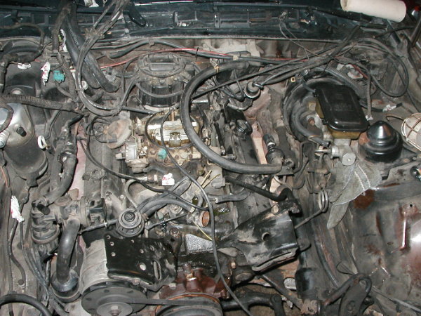

well i started my 305 to 350 swap tonight. we didnt get too far, got most of the wires and vacume lines off and labled. next is the motor mounts and the exhaust. here are 2 pics.. one of them is before we touched it tonight,, the other is when we stoped tongiht.

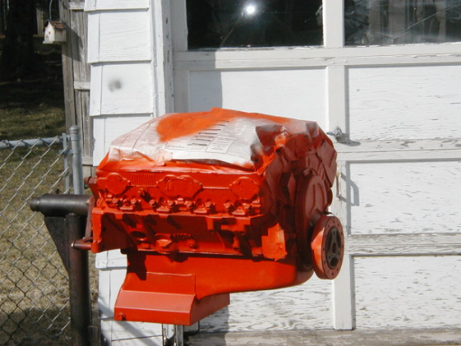

ok here is the freshly painted block

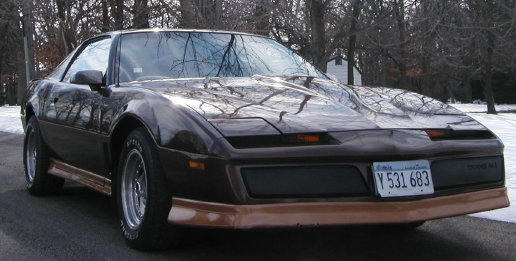

sorry man i didnt post to help ya out i just wanted to say that i gotta 84 TA and i'll HOPEFULLY b doing the same swap this summer
does the motor run a lot faster than the L69 or LG4 which ever one you had?
here is a pic of my baby....and hopefully it will have a 383 stroker by the end of summer....but im not keeping my fingers crossed
