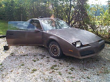

Does anyone have this set up? I have an 84 S/E with a H.O. V6 and it really needs a new muffler.
I know the Flowmaster sounds awsome on V8 cars (my bro has one on his 84 Sport Coupe 350 TPI). How would they sound on a V6? I don't want to sound like those euro cars. I want something with a throaty sound.
Do they make headers for the 2.8L V6 too? I would like to free up some HP with some exhaust mods.
Any suggestions or comments? Let me know.
this is for my 84 S/E resto project!
