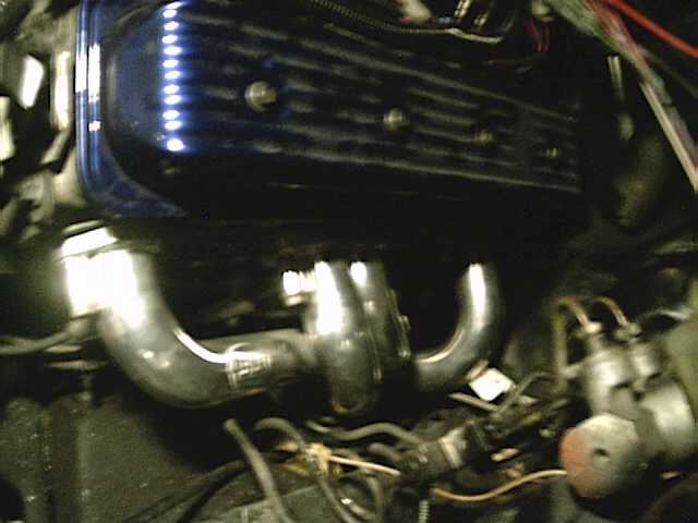

Old May 12, 2002 | 12:35 AM
ThirdGenZ28 92's Avatar
Posts: 425
From: Central Jersey
Car: 1992 Z28
Engine: Stock L98 with bolt ons.
Transmission: Stock rebuilt tranny with 2k stall and cooler.
Heres the driver's side but dont mind my filthy engine compartment. I wish I had sprung for the coating but I was tapped and it was all I could do to get the headers at all....
Old May 13, 2002 | 04:07 PM
Z28ricer's Avatar
Posts: 4,149
From: Tampa, FL, USA
Car: 93 240SX
Engine: LQ9
Axle/Gears: 3.54 R200 IRS
Dropped the motor with the pass side on and the drivers side I had to have the engine tilted slightly up to clear with the steering shaft in.
