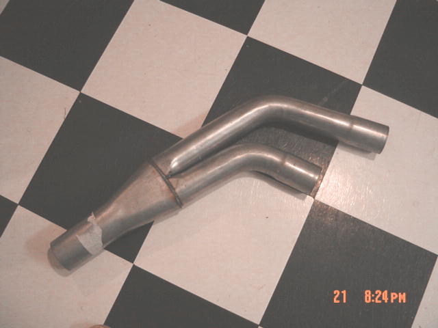

Pic of Flowmaster y-pipe for dual cats
This is part number FLO-16078 from Summit Racing for $46.95 plus shipping.
This is for dual converter cars for after the converters into the intermediate pipe. At least a 10hp/10tq gain over stock pipe.

I wonder if I can modify that to fit my Mufllex system?

I was wondering the same thing, thats a nice looking piece.

formul8
Are you going to use this on your existing slp cat back system?
What size are the pipes that flow into the y (pipes coming from convertors)?

I think they are 2 1/2 from converterts into the 3" collector. The SLP mid pipe has a step up welded in place to connect to the stock 2 1/2 after cat pipe. This must be removed and it looks like the Flowmaster piece is long enough to chop that step up off and weld in the flange.

wow that looks nice. I guess i should of waiting and ordered that. Instead i ordered just the collector and some pipe from jcwhitney and it's exactly the same price.

that is a really nice piece

Know what??? You just gave me an idea.
I wonder if that could be used (easily used) to help fabricate a "Y"pipe for some of the headers that come with cheesy size "Y"pipes???
I'll bet it could.
That is a nice looking piece.

Flowmaster sells what they call a Y-Collector. It's basically what's shown in the picture with two straight pipes instead of two bent ones. They make them in many sizes. Mufflex uses them in their Y-pipe kit. Check this list from Flowmaster: http://www.flowmastermufflers.com/cg...cgisortorder=0
