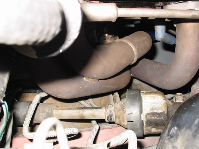

i will let the pics tell u the story.

moved the steering shaft over some.

came down to denting the header with a BFH! :lala:

see i used a piece of brass about the same size as the shaft then held it on place then my grandfather wacked it 3 times!
all i have to say is that they better add some power
it did rub before i moved the shaft and put the dent in.
now full travel of steering both ways no interference issues.. close but doesnt hit.
i moved the shaft/column from inside the car, remove knee pad, fuse panel and then three bolts on the firewall and two holding the whole column up near the top.

OUCH! Oh, man - I dimpled mine by putting about four thicknesses of shop rag over the tube and tapping it. Tap it, test fit - make a mental note of where it hits, do it again. I ended up with a fairly flat dimple that didn't cut into the volume of the tube very much, and it doesn't show very bad either.
BTW, why do your flanges and the first inch or so of your primaries look blue?

no clue why, i just got them coated, so what ever happens to them happens. that the dead batteries with no flash, they are not blue...
i am so glad i am done almost should be able to test drive the car with open headers tomorrow.
the two highlights were, denting the header and denting the oil pan

I don't get it. I never had this problem. I installed my 1-3/4" SLP's about three years ago and they dropped right in. In fact, I had to remove the driver's side header last weekend to get an EGT sensor bung welded in. Again, it dropped right in. Here's a pic.
with that much clearance they look like 1 5/8 when installed.
https://www.thirdgen.org/techbb2/att...postid=1320484
thats a pic Justins86bird posted in another thread.
i cant even get my header out, i still need to jack the engine up to get the header to slid out, but when installed it does have clearance now, and i am glad i am done with this installed.

Just a note about SLP's ever chaning quality. I don't understand why some people have problems and some don't - I wonder what is going on in the manufacturing process at SLP. Each individual set of headers is slightly different. I bought a set in 2000 with AIR tubes and at the time they looked pretty damn good, good welds, straight flanges, perfect y-pipe fit, etc. I sold those to get rid of the AIR tubes this year and got a new set. All I can say is that I have now realize what all the *itching has been about. These are an entirely different story.
My steering column hit the headers :

looks good HyperSpeed i was going to try messing around with that bracket down at the firewall but i didnt want to go through the trouble, denting the header was alot easier for me at least.

if your motor mounts are worn then the motor will kinda sag. it pushes the headers into the steering column. just get some moroso solid motor mounts, those things are bad!

yeah all i know is that my car is 100% straight, no accidents, no frame damage, etc...
the motor mounts looked ok but u never know.
i cant see how the cars can be that much different but who knows..
i had to dent mine and their is nothing else i could do. :lala:
Did you even try moving the steering column and shaft over? It is just 2 bolts that hold the steering column up. The holes that are there can be elongated even if there isnt enough adjustment in the first place. I sure as heck would have tried to find a way around denting my headers.
Ben
Yes, I read that but then i read this, and wasnt sure what he was referring to here. Anyway, if he didnt I would have still elongated the steering column bolt holes instead of denting the primary. It looks like he got it almost far enough over without denting it that I bet if he would have elongated it a bit he would have been fine. So is there actually adjustment at the firewall too? I never really looked.

some have to dent, some dont, some try new mounts and still have to dent, some try moving the column like me and still have to dent..... the list goes on of trying to get them to fit..
slp = ok in my book.
