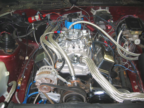

I'm not sure if you want to go this route, but March performance pulleys sells one for like $100 bucks. It looks really good but it is kind of a pain to adjust.
wherd ya find it>? does it work on a 3rd gen 305?
Old May 28, 2003 | 09:23 PM
MCas7's Avatar
Joined: May 2003
Posts: 484
From: Lisbon, NH
I bought mine at summit. It fits a small block chevy. I don't see why it would work.
