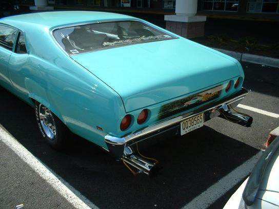

do it just make sure you have money to buy new bumper covers and for paint becuz you will not be lucky enuff to keep from melting them.
that pic is from work, a fellow emplyee has that chopped nova and a ford that also blows flames. both cars shoot about 60ft flames that reach about 35-40ft in the air.

heres the set up on the same car. theres a fuel line from 2 tanks of compressed gas and i think one tank of colmen fuel also, then the spark plugs. theres no cats but its not hooked up to where it will work with cats or no cats.
