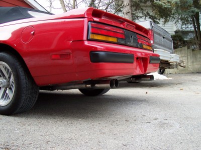

Here is a pic with the hooker cat back without the included tips. I too thought they weren't that nice plus they rusted really really quick. I think they have since changed that problem but I went with borla tips and it overall makes the system perfect. I know this doesn't really help you but it will help you see what other tips look like on this set-up.

Here is a pic, with the included tips.
You will want to get the tips welded on if u can.
They dont tighten down very well.
Otherwise the system is great.

Excuse the bad pic:lala:
