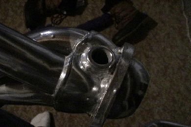

i just got my 2055s and was wondering if this is the o2 sensor hole/whatever it screws into. Sounds like it but thought i'd double check.

yup

sorry to bring up the old post but it seems like my o2 sensor hole is on the wrong side of the header. Its located on the side that will face the firewall, not the side that faces the accesories like is on the maniflod right now. Did hooker weld the collector on backwards or is there something special we're supposed to do to it to make it fit? that wire connecting to the o2 sensor looks pretty tight as it is, i dont think it will reach around to be in the back. If you have questions about what im trying to describe just ask and i'll try to get pics up by tonite.

My headmans are not hookers.... -er, my headers are Headmans...
My headers came with the bung for the O2 senson facing the firewall. They also came with a wire to extend the stock O2 sensor wire and make the connection...
There was NO clearance problem with my headers and with the wire extension it was no problem connecting the sensor up...
Hope this helps!

The extension wire was very similar to the wire coming off the O2 sensor. I couldn't tell you what that wire was but it was something that handled high heat. You might give ACS a call or email. Since they coated your headers they should be glad to help. I found them to be VERY HELPFUL when I purchased my headers from them. As connections go they connected with clips that mated up with the existing connectors in the system...
If you have a "Speed Shop" in your area you might check with them. This is a very common issue when installing headers.

i guess its related to this thread, but would it matter if the o2 sensor was on the passenger side header? im lookin for some hooker 2210s and i got mail from someone who said they have a pair that has one on the passenger side

Shouldn't matter
It shouldn't matter if the sensor location is on the other side. The result would be a long wire run or re-routing of the wire between the O2 sensor and the computer...
