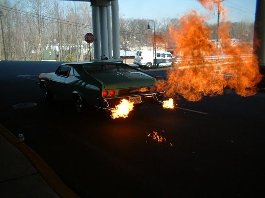

How are you goin to put your injector in your exust? it better not be anywhere farther the the tip of the exuast. other wise u will blow your car up or have a really great chance on settin it on fire. if your entending on blowin flames liek the pic im goin to post then your goin to need to read up alot on it and ask around at carshows were guys have flamethrower setups on and not just those ones that kill the coil to dump raw fuel into the exuast.
that nova has a custom put together kit and it doesnt use gasolene. that guy also has a 34 ford with a flame thrower kit on it he built, he set the back of his car on fire once and that was set up right, it just came back and bit him.

it doesnt matte how u think your set up is differnt the others. the picture i posted the guy has the spark plugs almost 4'' awayfrom the end of the tips, all the other kits ive seen , even the one they did on Trucks on Spiketv, said placement is 6''.
