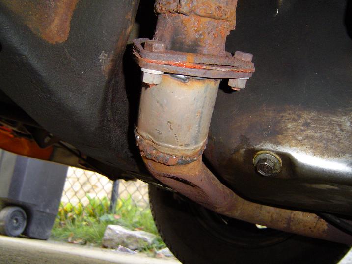

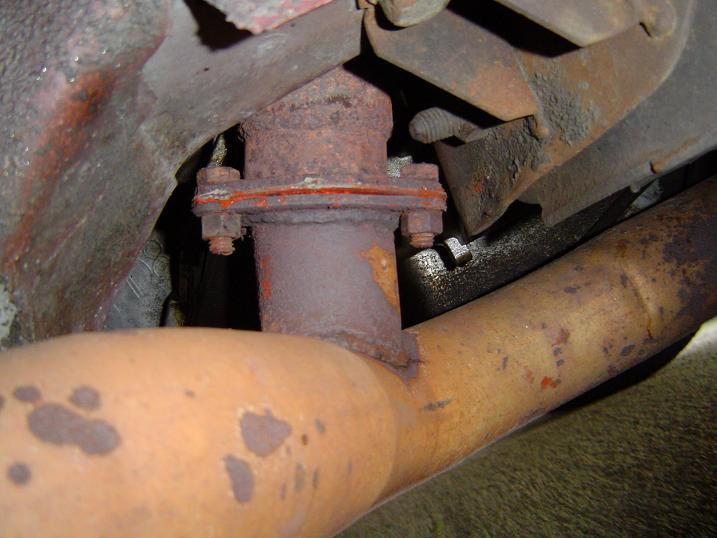

if each side which is 2 1/2 goes into a 3 inch id be fine with that
heres what i got now
i cant afford a whole new set of headers just to get the y pipe

Ouch. That goes beyond ugly.
Two 2-1/2" (or even 2-1/4") into one 3" is fine. You don't need 3" downpipes.
Getting a decent one fabricated seems to be a challenge. That appears to be a muffler shop job (looks familiar for some reason). Getting it done by a performance exhaust shop that knows what to do will put you back in the mode suggested by the repair shop.

The best way to fabricate one yourself is with pieces of 2-1/2" & 3" straight pipe, mandrel 2-1/2" & 3" bends, and a Flowmaster 2-1/2" to 3" Y. Your search should have uncovered one done in such a fashion.
Based on your photos above, you'll notice a difference even with a collapse bend (like the one at the shop you're talking about) fabricated y-pipe.
