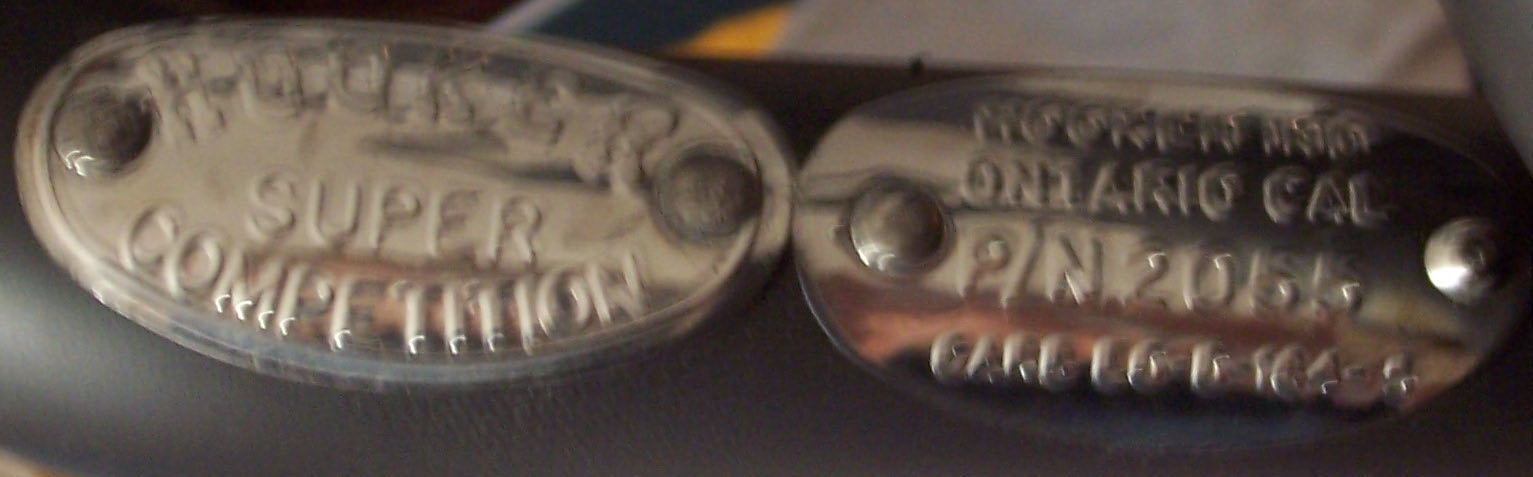

I got a new pair of Hooker 2055 Headers. I am planning on coating them. I ordered "Black Satin" from Tech Line. I want to be able to coat the entire header. Is there any ideas on how to remove the tags that are on the headers as seen in the picture.

I want to remove them so I can coat the header. Or should i just paint over them? I'm using the black satin stuff from tech line. I didn't think it would be a good "seal" if i painted around the tags. So i just thought i could remove them. And then paint the headers.

Are you going to "coat" them, or paint them?
If you're getting them coated, don't worry, they'll clean them thoroughly and the coating will stick just fine.
If you're painting them, clean them thoroughly and paint away.
I painted mine over 3 years ago. The tags are fine.

There's no need to remove the tag (usually tack welded on anyways) unless you just don't like the look of it.
I've done a few headers with tags and haven't any problems using Cermakrome. The 'birds...

Well i was going to coat them myself. But in order to coat them I first need to "paint" the header. I don't know whether to remove the tags then paint it or to paint right over them. I'm going to use black satin from tech line.

The tags look like they are about to come off anyway. They are bending up on the sides. I think I'm just going to take a screwdriver and pop them off unless someone gives me any other ideas.

Make sure those rivets don't go through the header if you pop 'em off, or you might end up with some holes, unless you're going to weld them up.

I just did my set of 2055s too, although I additionally removed the AIR equipment. As for the tags, ya I didn't like them too much either. I got a 'sharp' screwdriver and gave it a good whack from the 'inside' underneath of the tag with a hammer and it busted through the weld (mine were tach welded I believe). I used some ceramic coating I got from Columbia Coatings and it turned out well. I cleaned them up with a clean rag, and although they don't look polished by any means, they do look pretty good IMO, a lot better than the last pair I did with the same stuff (didn't clean them up after coating last time). I'll grab some pics when I go home this weekend.
