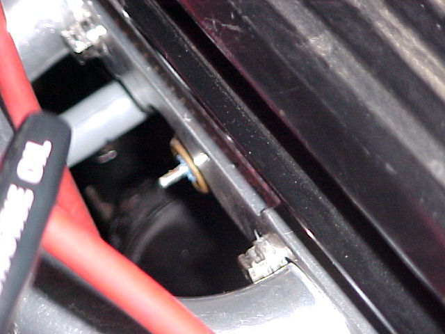

My dad has hooker long tubes on his truck and they are very well made. I've heard the same for Hedman. For $135 from summit, I'm going to be gettin the Hedman long tubes. My local yocal exhaust shop here made me a y-pipe for $90. Its about a good a quality as my flowtechs.
Hurray for Flowtechs!!!!!!!

Stage 8 locking tabs won't work with the flowtechs. The primaries are too close to the flange holes for proper clearnace. You would have to go with breslins. Also, don;t forget that you cannot use the gaskets that come with these headers. You will burn them out in 5 minutes (no exaderation). I was warned about this when I bought mine and I shrugged it off. Soon after I started the car I had to go and buy nice fancy header gaskets. That is an additional cost that you won't have to do with the 2055's. Custom fabbed y-pipes are nice but they come at a cost. I hope you can get a good deal from a shop that can do mandrel bends. I still think you are better off trying to save a few more bucks for a set that doesn't need much work.
Really? I'm glad you said something, now I can go take them off. Just think, I've had them on for all this time and now I find out they don't work.
Is the sarcasm that necessary? I have had these bolts and headers for over 3 years now so I am not making this up. Maybe you have a different set of fixtured flowtechs from when businesses switched hands.
Did you grind down the tabs? I could only manage to get a few of the tabs on. I left them off after repeated attempts. The head of the stage 8's were literally touching the primaries on my set.
Old May 3, 2005 | 05:53 PM
  #45
ShiftyCapone's Avatar
Supporter/Moderator
Posts: 13,776
Likes: 567
From: Cincinnati, OH
Car: '90 RS
Engine: 377 LSX
Transmission: Magnum T56
Case in point

You're right, sarcasm isn't necessary. I apologize.
The clearance between the head and the tube on mine is similar to yours, and yet I was able to fit the locking tabs over the heads in all but 3 cases, where nothing more than a little filing was necessary.
There does seem to have been a decline in quality since the acquisition by Holley. My original supplied gaskets didn't burn out, and that was back before I had the Stage 8's on and I was having trouble with the header bolts backing out. I replaced them with a cheap set from Mr Gasket (P/N 150 or something like that I believe), and they continued to seal just fine.
This is what I should have done. I couldn't justify grinding on my new $40 header bolts though. I ended up losing the tabs when my tools were stolen so there is no chance of me trying now I was just so dissheartend when I installed these headers that I didn't want to throw more money at them.
It sounds like you got yours right before the poo hit the fan. These headers are just a few quality steps away from being a decent header. It is sad that they couldn't make just a few slight changes. I will be removing these headers here in a few weeks and I plan on posting some of their quality issues to look out for.

You should be able to get new tabs for the Stage 8s if you wanted to use them down the road.
As I recall, the issue preventing me from putting those 3 tabs on was the clearance at the top of the bolt head where the tubing started to bend, not the clearance at the base where the tab actually rests.
This makes sense. It has been awhile but i remember that if I backed out the bolts a tad I could get a few more of the tabs on. However, I didn't like having any bolts even remotely loose and was afraid the tabs wouldn't work on a bolt that was loose. You woulnd't happen to know where i coul dbuy new tabs would you?
