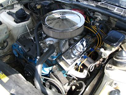

I put in mine on the weekend. I had no interference problems at all, with anything.
The pass side one went right in, and the DS one went in from the top, only removing the valve cover on that side. They fit great. There is no O2 provision though, you are on your own for that, but its not expensive.
The Y-pipe fits great too, but I cut mine off in the middle of the collector so I could have a true 3" exhaust system. The I-pipe it comes with is 2.5".
