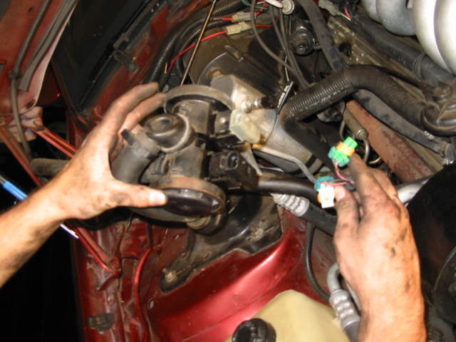

what do i do with the emission plugs that comes from the computer to the emissions equipment. i will go get a picture of what i am talking about.

here is the pictures of the plug ins i am talking about. sorry i dont know the name of these things

just leave them unpluged and stow them up. thats what i did when i had my 305. u wont get any light

i started today and it looks like its going to be a job. i took all the smog stuff off and out except the smog pump, i tried but my torque bit bent.... lame. but ya ill take the manifolds off tomaro and in goes the headers. im also replacing the plugs wires and cap and rotor while im doing this so hopefully it will livin this motor up a little.
EDIT: i have another question. how do i take the ac stuff off that is up by the firewall? i would like to move it to make the passenger side go better but i dont know how to take it apart to move it to the side.
another question... what spark plug wires should i get? i cant just get stock replacements they have to have a 90 degree boot? rwdtech i know you were the one that mentioned it so i will ask. you put on the spark plugs for a 94 truck and arent having a problem with them or is that just what you are suggesting i get? i need to find out what spark plugs to get b/c im going to autozone in the morning to get everyhitng.

did any of you guys have a couple stripped bolts when you did this? i have two on the driver side and i cant get them off. what should i use to remove them? also how did you guys get the last bolt on the passenger side out?
im going to be doing this all week this is much harder than i thought it would be theres no room at all on the passenger side... all i have left though is the last bolt on the passenger side and the two stripped bolts on the driver side. then i can take off the manifolds, i got the y-pipe and cat off. im going to have to cut the cat off the old y-pipe though.

I found that the passenger side was not really that hard. It was easier to instal the passenger side compared to the drivers side. The passenger side just fell into place from the top of the motor with out having to move things out of the way, the only thing i had to do was take the fan switch out, other than that i didnt have to do anything extra that it took me to take the stock manifold out. The drivers side i had to unbolt the steering shaft. That was the hardest part of getting the headers in. Didnt have to unbolt the engine mounts and have plenty of clearance on each side.
first of all that must be an uncommon lucky experience
and yes i have plug wires for the 94 truck because i didnt want to cut and crimp my own wires or pay all that money for aftermarket wires. they are doing just fine, the havent melted at all. Just make sure u route them so they arent touching the headers
ok so you stripped the bolt head? have you tried wrapping a piece of paper around the bolt head and then sticking the socket over it? if that doesnt work try putting a smaller socket on it...make sure you are using 6 point sockets. if all else fails go to sears and get their stripped bolt remover set
you will need to remove that last passenger bolt from under the car
Old Apr 17, 2006 | 05:03 PM
And keep soaking those bolts with pb blaster.

the edelbrock TES are designed differently than flowtechs and other headers. ive talked to people who have installed other brands of headers and said it was easy. but you probably know what youre doing too

rwdtech...you shouldn't think its bs...my headers were easy to put in on the passenger side...just had to slip the header over the Oil Dipstick, but no issues really..i think some people's motors grew over time making the header install difficult...i guess mine didn't grow that much

I was installing SLP headers, I know a little bit about what i am doing but i was expecting it to be hard since i know its not easy stuffing headers in there and everyone else i know that has done it says its a pain so i went in there thinking it was going to be a pain. So besides me being lucky, nothing stripping or breaking it was pretty good. As long as you take your time and dont get frustrated

Only advise I can offer
along with all the install stuff dont forget 1. take the next day or two off. 2. get some beer if 21. 3. learn to curse in a few diffrent languages so not to offend anyone near by.
Most important, take your time, if you rush you will forget something.

alright i got to work on it a little bit today. i worked on it for like an hour or so. i got the driver side manifold off and the header looks like it is going to have to go in from the bottom. the thing that killed me was those little metal clips behing the bolt on the manifolds that connect one bold to the other i had to push a little metal piece to the side that was like right on the bolt so i could get the socket on there.. i know that sounds stupid but i couldnt figure out what i was doing wrong and that was the problem. i havent messed with the passenger side too much yet, i got the heat shield off and out of the way so now i only have to take the bolts out.
i have a quick Q though... how do i take the dipstick off? i need to get it out of the way but i cant figure out how to take it off. PLEASE ANSWER QUICK B/C I NEED TO GET BACK OUT THERE AND FINISH IT UP. i cant do much with the dipstick being in the way.

the dip stick bolts to one of the manifold bolts. Once that is out, give the dipstick a little pull. It just slids into the block/oil pan.

Pulls out with a little force, be careful mine broke.

yes it takes quite a bit of force to get it out and its hard to get a good grip on it
good thing you got the heat shields off cause one of my heat sheild bolts got stripped and it took me forever to get off
