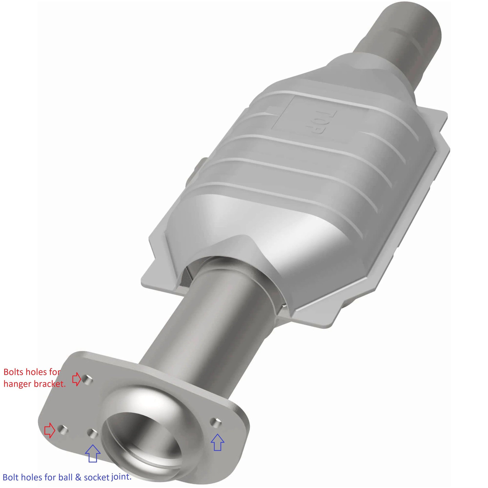

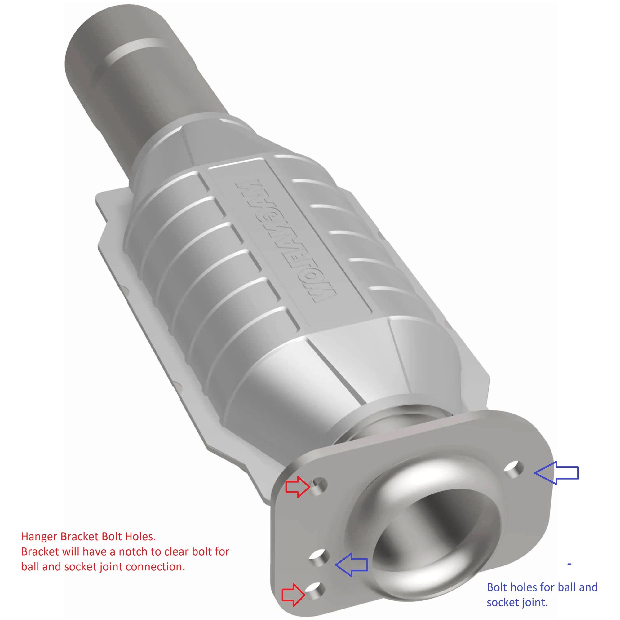

Hi friends, this is my first post/reply so go easy on me if I'm doing it wrong or in the wrong place.
I'm finally ready for performance exhaust and I'm having a problem because all the bigger contenders seems like only offer "Non HO" cat back packages.
What am I missing? Or how do I go about getting more airflow out?

Don makes excellent headers, Y-pipes, and other exhaust system components. Yes you should use Don's matching headers and Y-pipe together.
The Magnaflow catback for our cars is somewhat universal in that it will work with the low output single cat, the high output single cat, and the N10 dual cat cars. It comes with different pipe adapters for the front of the intermediate pipe where it connects to the catalytic convertor.
It's not a 100% bolt in for all F-body cars. They don't make an adapter for the 1983 to 1985 4 bolt flange with oval inlet and outlet catalytic convertor like your car has nor does it fit the factory 1989 to 1991 style N10 dual convertor Y-pipe with the "Hog Clamp' style connection. It probably doesn't directly fit the 1991.5 to 1992 factory N10 slip fit style Y-pipe either due to 2.75" vs 3.00" outlet and inlet diameter so both style factory N10 dual cat systems will need some work done there. If one uses Magnaflow's N10 dual cat Y-pipe it's a direct bolt on with Magnaflow's cat back using no adapter.
The Walker 35245 hanger has the bolt pattern for the smaller low output single catalytic convertor as used on V6 and low output V8 LG4/L03 TBI/1990 to 1992 TPI low output single cat cars. The High Output single catalytic convertor for 1986 to 1989 used a different bolt pattern on the convertor flange. I'm going to look around and see if they have one for another application that looks promising to use with their H.O. convertor.
High Output Convertor
Low Output Convertor
