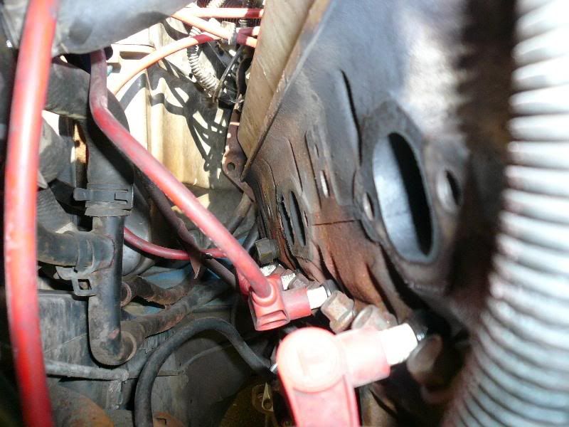

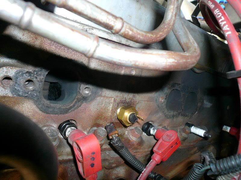

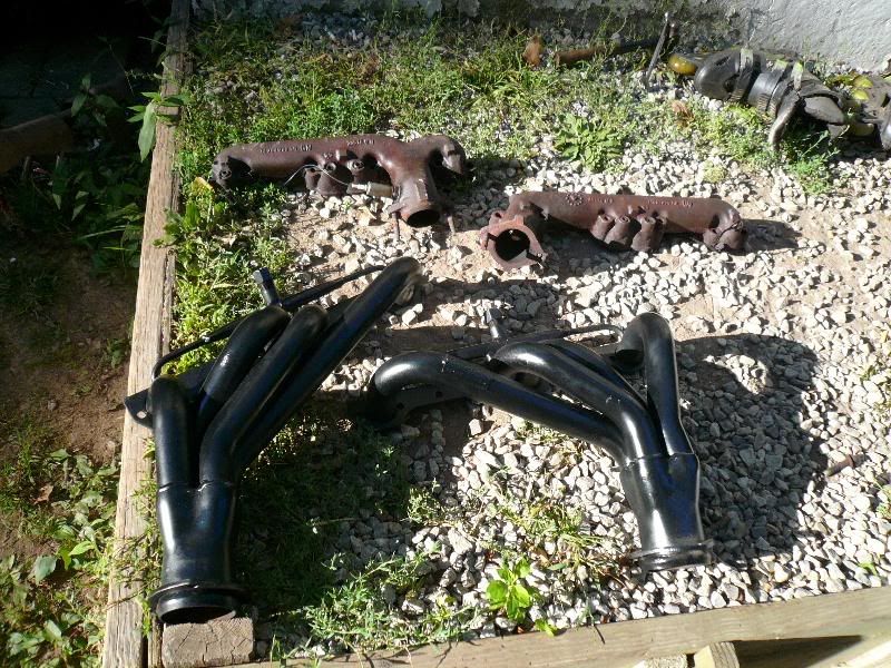

Alright heres the progress!...
Passangerside was a bit easier like everyone said.. only thing is i took out the fan switch sensor, and 3 of the 4 spark plugs. Also i ended up taking off the metal heater hose lines which were old and rusty anyway.. which i will replace with the regular rubber heater hose.
Driverside was a freeking B****, had to take off the steering column like others had said and i ended up taking off the ac compressor which gave me a lot more room.
All thats left is to put everything back where it goes and bolt up the headers, which i did get the stage8 locking bolts, and i did go to autozone and buy those alum collector gaskets. Should i get those alum header gaskets also or is that a waste of money and pointless?
i actually am most likly going to pops auto, i have delt with them in the past and they do way better work than fastgo. Unless someone has a good shop near manchester ct that ill make it to with basicly open headers... and the y-pipe connected! Im not sure what exhaust ill be going with yet.. i dont know if i really want the flowmaster sound kind of sick of it even though i dont think mine is the 40 series. Yes ill get the highflow cat and the whole 9 yards.. depends on what i find online and what pops/exhaust places offer me. I personally would like to ahve the car for this weekend but if i have to wait for an order then i guess ill have to wait.
thanks for all your responses!
