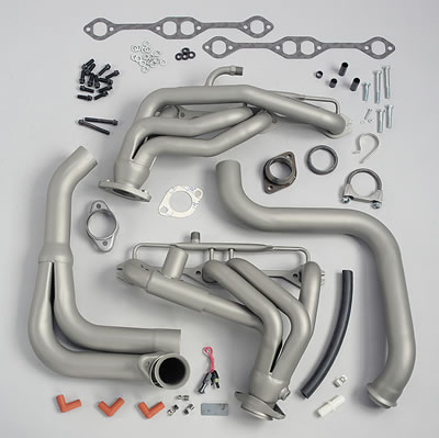

Here are some pictures of the two of them (I chose ceramic coating since they look better)
Hooker 2055
Hooker 2460
In all my time on Thirdgen.org, I've never seen anybody recommend the 2460 over the 2055. The ease of install on the 2055 what with not having to build or use a crummy Y-pipe just makes sense.

Well, the non-ceramic coated 2055's, http://store.summitracing.com/partde...5&autoview=sku
Is $449, around the same price as the edelbrock Ti-Tech Coated ones, heres a pic of those http://static.summitracing.com/globa...dl-68753_w.jpg , i could be wrong but that looks like the heat stove to me, on one of the headers, not that it matters, i'm getting the non-ceramic 2055's.
